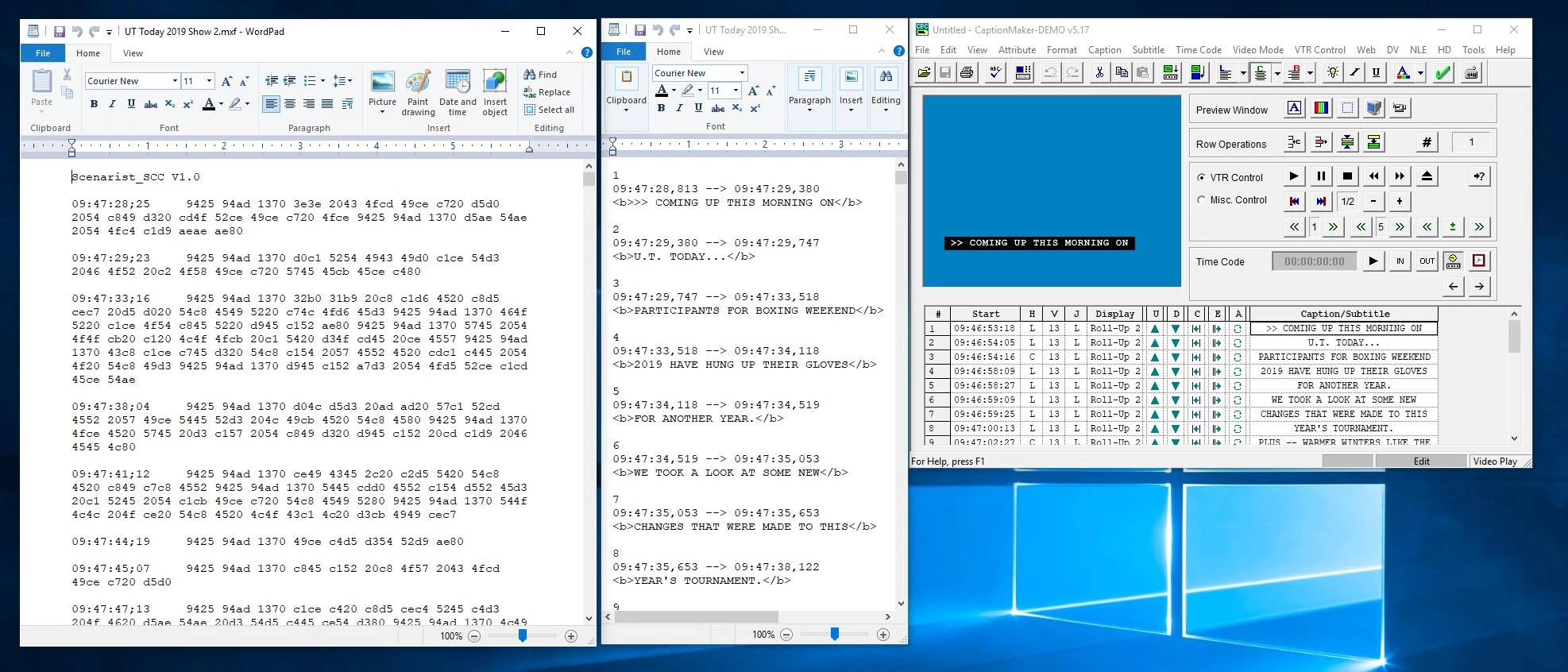

I ran the file through some old captioning software (CaptionMaker) from 2011 and can confirm that the time code issue is with Media Encoder.  Image below shows CaptionMaker's start time for CC text is 09:46:53;18.  I'd use this software, but the dongle doesn't work with Windows 8 or 10.
I exported an scc file and a subtitle file in AME and the same file open CaptionMaker.
