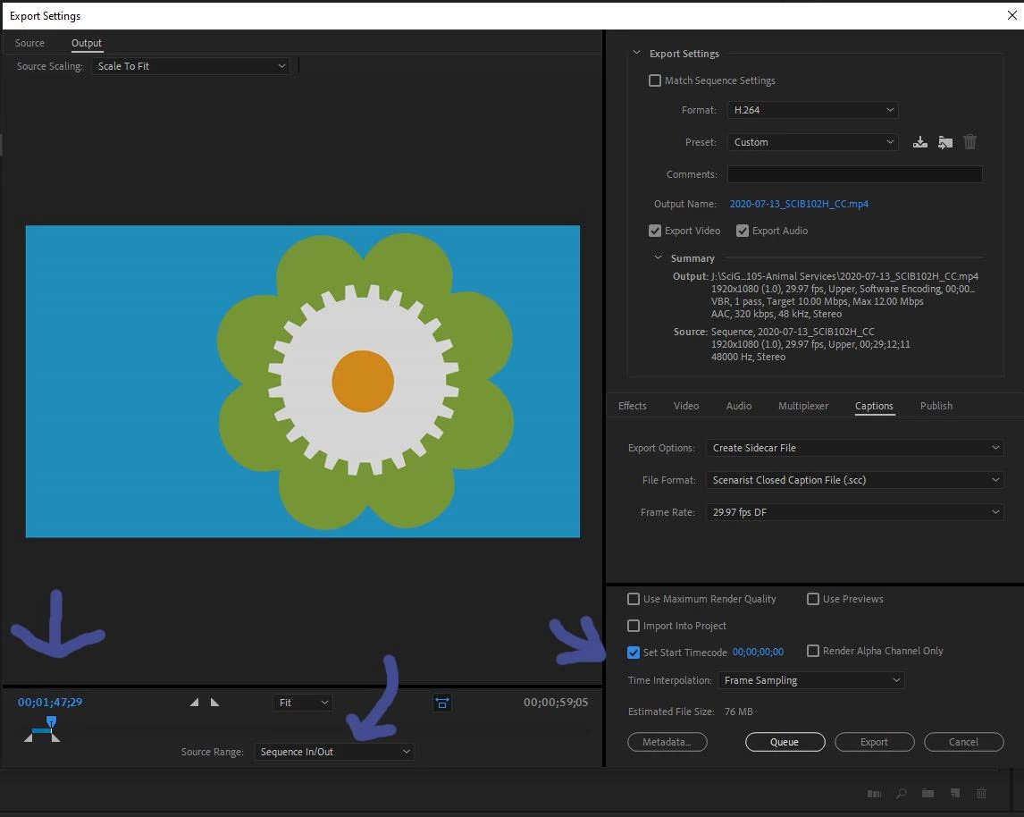

Sorry for the delay in responding. I needed to run some tests to see if I could understand what is happening: I can't understand it, in part because I can't really get any difference in the media file itself using the "Set Start Timecode."
But I believe that caption streams do not support this function anyway.
a) There is a UserVoice request regarding this:
https://adobe-video.uservoice.com/forums/911233-premiere-pro/suggestions/35979748-bug-in-media-export-set-start-timecode-option
b) I don't see how it would work as captions are currently created. Not that it matters, but what you are seeing is probably not the "caption file" times, but the caption SEQUENCE times, which, in any event, are not being adjusted by the Set Start Timecode. If you have not changed the caption times from an imported caption file, then the sequence and file times are the same.
Possible Workaround.
Use a third party program such as SubtitleEdit. Bring the exported srt in, and adjust the timecodes to zero there.

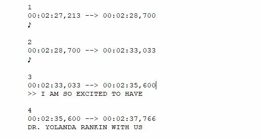

Oct 26, 2020 5:24 PM UTC
Hi.  I have tried trimming and exporting from Premiere as well as Media Encoder.
The goal is to take a finished broadcast version (with bars/tone/slate at the beginning for broadcast) and export it from in/out points with sidecar file. I need the sidecar file timing to start at  00:00:00 like the video so when it uploaded online, it matches.
That being said, if the "Set Start Timecode" feature in the export does not apply to the sidecar caption, what is the purpose?
Attached is a sample of my export screen and a sample of how the the captions still look even after I've used "Set Start
Timecode."
