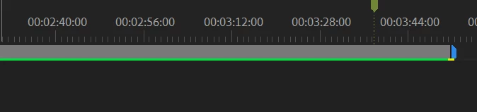

September 29, 2019
I finally found my fix. Somehow the timeline didn't have my area that I wanted to render actually selected. I know that I pulled the ending to the end of the video that I wanted generated, but somehow the beginning and ending of the sequence to be rendered was at the same position.
A helpful thing to do is to look at the top of the timeline. If the bar is yellow or red, it's not rendered yet. If the area is green, then it's rendered and potentially could be successful. Refer to this video which kinda explains it, but has a different problem that he attempting to solve

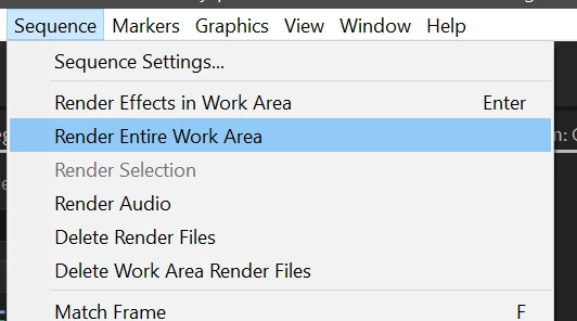

After ensuring the appropriate section of the timelien is done, Go Sequence menu: Sequence -> Render Entire Work Area. It should take seconds to minutes to render unless it's already green. Try going to Sequence -> Delete Render Files. Then attempt to Render Entire Work Area again.....that should take longer. If not, ensure that the appropiate sequence is properly set!!!
