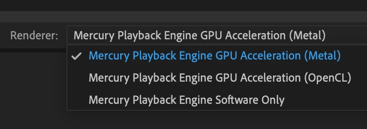

set the renderer to GPU acceleration in ME

Hey Paolo,
Have you enabled the Mercury Playback Engine > GPU Acceleration?
Kevin
Paolo741Author
Sep 16, 2020 3:52 PM UTC
If you mean selecting renderer: mercury playback engine GPU acceleration (CUDA), of course yes.
