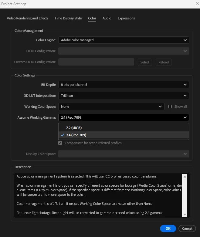

If your comp looks right in AE but dull/washed-out after sending it to Media Encoder — it's a gamma mismatch, not an export bug.
Dynamic Link expects Rec.709, which is gamma 2.4. Fix it in the project, not the export: File → Project Settings → Color and set Assume Working Gamma to 2.4 (Rec. 709). This makes the queued render match a direct export.

After Effects sends a Rec709 output to AME. So you can set the Color Space to 709 and then send it to AME. Not ideal. We want to fix this. But here's a workaround till then:
  1. Go to the File -> Project Settings -> Color tab -> Color Settings section
  2. Change the Working Color Space to "Rec.709 Gamma 2.4"
  3. Uncheck "Use Display Color Management" from the "Channel and Color Management settings"; those color-rings right below the monitor. (This is only to confirm that the color values are the same, immaterial of the display color space)
  4. Now export to AME.
The exported file should hopefully not have the color issues. Please let us know how this goes. If you do want to bring the output file into After Effects to compare, please note that you will need to disable the Display Color Management for it again and then compare the colors.
Apr 24, 2024 7:02 AM UTC
Yes, now the colors are correct.
Thank you for your assistance, both of you.
