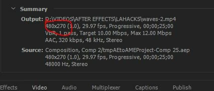

Why is the resolution different when I try to export on AME?

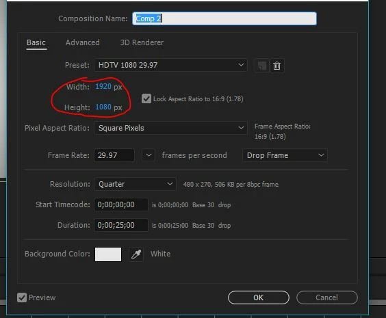

Check this out: I have my composition settings to 1920x1080 and then i press export to AME and the source says its 480x270? What's up.
ajmacleanCorrect answer
Nov 18, 2016 8:01 PM UTC
Apparently it's a known bug. What I found is that the "Source" resolution seems to be pulling from your viewing resolution. So if you have it set to preview at a quarter or half, it'll use that rather than the project settings. Make sure that's set to "Full", SAVE IT, then send to AME CC.
timcmonkey​
timcmonkey​
Nov 18, 2016 5:33 PM UTC
THANK YOU! I could not understand why my exports looked like muddy crap all of a sudden. Any help from anyone, please?
