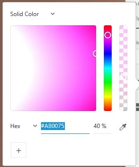

I have this strange bug where my color pallete looks completely broken. Any idea how I can fix this?

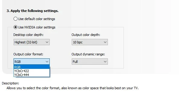

    Since this is one of the top results searching for solutions to this, I'll share this here as well.
    For those looking for a solution to this, here is what worked for me after 4 days of troubleshooting:
    Turn off 10bit color mode, switch it to 8bit.
    On windows, with an Nvidia GPU, I changed this in the Nvidia Control Panel.
    The weird thing for me is that sometimes it'd work with 10bit and then the next time I'd start XD it'd break again. It seems like it is an issue with Windows 10 UWP apps in general as transparency effects in other apps using the "fluent design" framework were having similar issues as well.
    Hope this helps some people out.
    ze_edboy
    Jan 13, 2022 9:25 PM UTC
    Just to add to what @Uplynxed said, try setting your output dynamic range to full instead of limited. That sorted my issue out

    I don't have SRGB in the color settings of my monitor.
    Look at the image below
