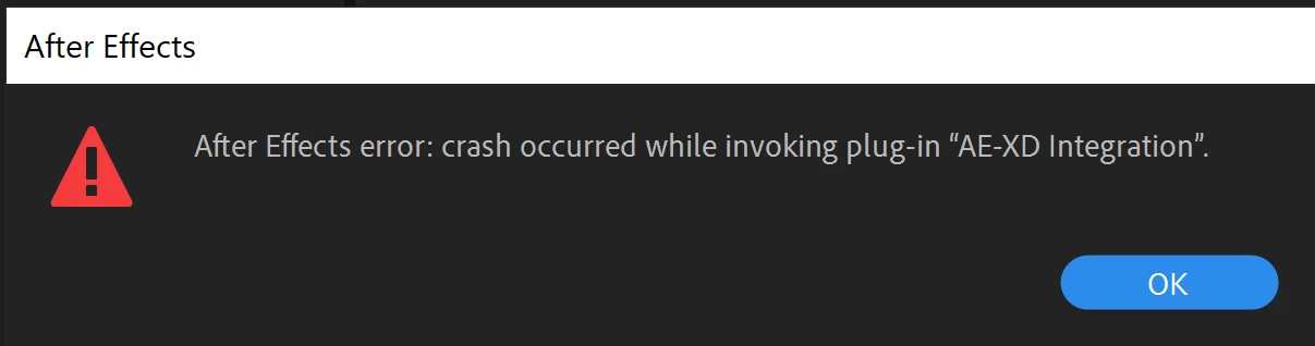

Adobe XD crashes when exporting to After effects.
what to do?

July 19, 2021
I hope my answer will be helpful. ) I had the same problem when exporting artboards to After Effects. I was thinking, why do some artboards export without problems and some of them crash the whole Adobe XD. And I simply started to add/remove different elements/objects from my artboards to find out which of them are causing the problem. And found such! After I removed these elements (it might be images, text blocks, whatever) I tried to export artboards once again. And everything worked fine. I restored deleted object in After Effects. This might be the solution. 😉

July 27, 2020
Hi Lotem,
I am sorry to hear you are experiencing issues while exporting the XD file into Artboards. In addition to what Italo has asked, could you please see if any plugin is causing a problem as the error box is from After effects and says about the plugin?
We will try our best to help.
Harshika
