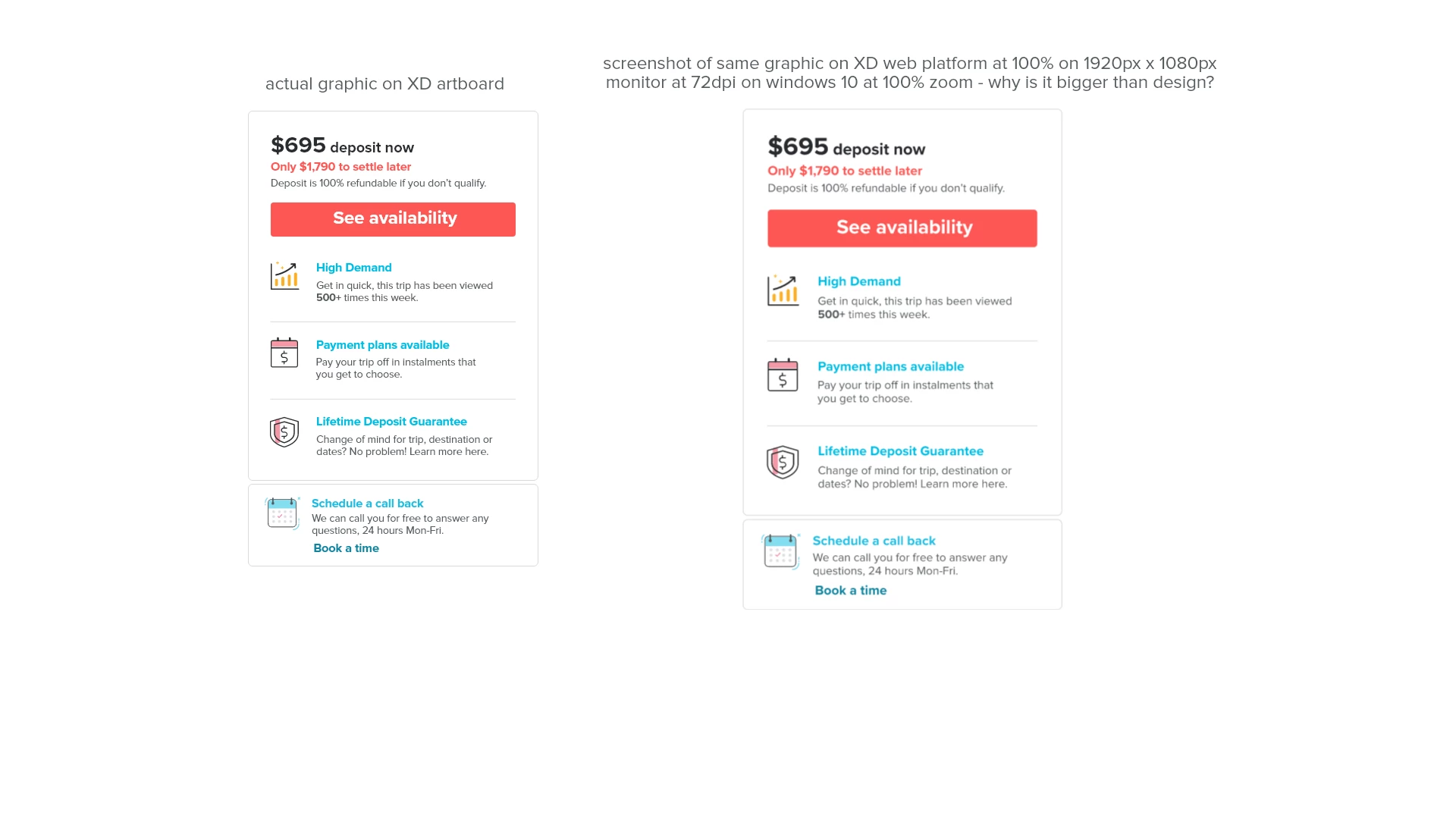

The problem is resolutions on retina displays work the same as on mobile devices - they use scaling.
Your logical resolution is 1440x900, and 1920x1080 is bigger than that, so when you open the prototype everything looks smaller as it's scaled down to fit. 1366 naturally fits, as it's smaller, and you see it at 100% - everything matches.
At least that's how I understand it, it's a bit hard to keep up with all the resolutions, devices and so on 🙂

Is there a fix for this yet? Is it better in sketch? If so I will need to change programme. I am having a nightmare with developers because all fonts look WAY bigger than my design once coded and in staging.
Spas K.
Dec 20, 2021 6:31 PM UTC
It's not an issue to fix. It's a feature that might be useful, but hasn't yet been implemented.
As far as I know, most design software (including sketch & figma) doesn't support designing in rem units.
Your developers should know 16px = 1rem (in most cases). It's not that hard of a calculation 🙂

We just discovered a potential underlying cause here that's outside of Xd -- Windows 10 has a default setting to zoom everything to 125%, so one team member working on windows was seeing different things than folks working on Macs. Not sure if that's your issue, but changing that setting on our end is at least part of the fix. Still scratching my head on the larger implications of most Windows users seeing everything 20% larger...
Jun 20, 2020 12:46 PM UTC
This is not the correct answer - Adobe, stop creating fake accoutns to mark this UNSOLVED, FUNDAMENTAL issue as fixed. windows zoom is not causing the issue, it happens on different monitors with different zoom levels and on mac also. XD is not rendering accurate font sizes, or at least not matching web browsers rendering of font sizes- this makes XD useles as a design tool for web UX.
THIS IS A BIG PROBLEM!

I don't get it.
Let me explain to you again: For example;  Google font Montserrat font size 16 and same font size on adobe xd look smaller. It's a problem for designing and developing.
If we share the preview to the client and developer, the final product looks different. There are other designers they have got the same problem as us. And developer can't download JPG file.
Currently, we switch to Figma. Definitely, other features are good but the different font size is confusing .
