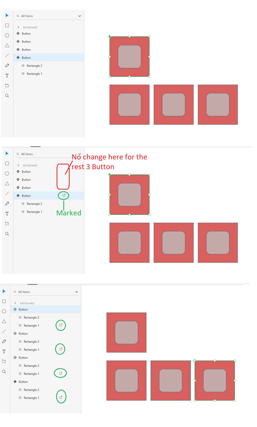

Hi there. I am facing an issue with "Mark/Unmark for Export'' ... it's not Syncing with all the components when I am changing it in the root component. But inside the component layer it's working.
Say ... I have a component "Button'' which consists of "Rectangle 1" and "Rectangle 1". And I used this "Button" in 10 places in my design. Now when I check the "Mark for Export" in the root "Button" component then the rest 10 "Button" do not get the change. But if I change it in "Rectangle's" then all Rectangles inside 10 "Button" get the change.
Any advice if it's possible to "Mark/Unmark for Export" for components.

    Sorry for the delay in response. I checked with the team and according to them this seems to be working as designed. But they are definitely looking into this for making improvements. They have kept the bug in testing status and didn't closed it.
    I will let you know if I have any more updates on it in future.

    Hi. Sorry screen record is not able to but sharing some pictures and this should be Ok to clarify.
    - In my design I have Component Button which consist of Rectangle 1 and Rectangle 2. And I used this Button 3  times on the ArtBoard.
    - Now if I mark the root Button Component for export then the other 3 Button do not have that change effect.
    - But if I mark an internal Rectangle of root Button then all other 3 Buttons that Rctangle get that change effect.
    Please advise how to fix so the Mark for export will effect take place in Button Components.
