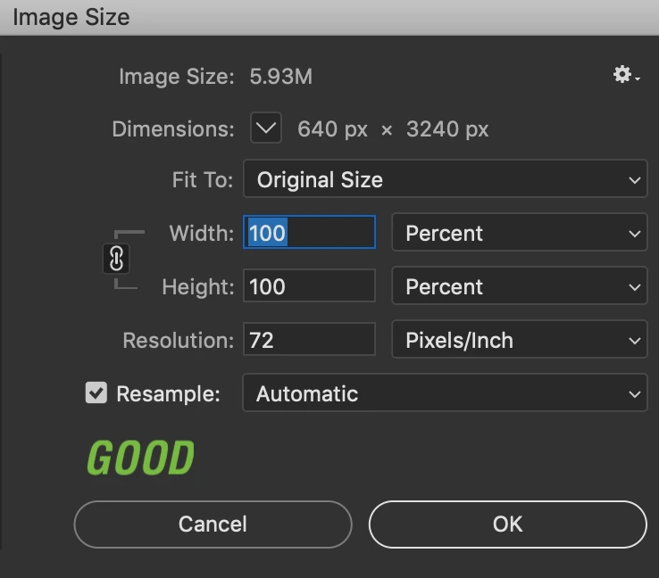

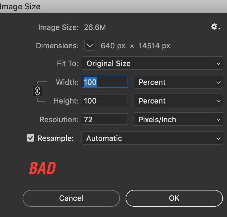

I have two PSDs, same file setting for both files. I made JPEGs out of both of them to import into Adobe XD. I exported them 3 times the size in Photoshop so they are high resolution in XD. When I share my XD link with my client, one of the jpegs end up being super blurry while the other one retain it's high resolution. I believe it's something to do with the export setting in Photoshop but they are both exported the same way! Please note all the other elements in my presentation remained very high res, except for that one jpegs. I tried carrying all my layers from the PSD that's exporting the blurry jpegs into the PSD that exports high res jpegs and it solved the issue. But the thing is that, majority of my project is built with the low res PSD and I can't help but think there's a setting that can fix this issue. but yet again both PSDs are created using the same settings and bits.

I have the same issue. I figured out that it's to do with the size of the image (i.e. nothing to do with the JPEG compression level). Your good example is 3,240px height while the bad example is 14,514px height. I bet if you crop the bad image to 2,000px height and re-import, the image quality in the web preview would be good.

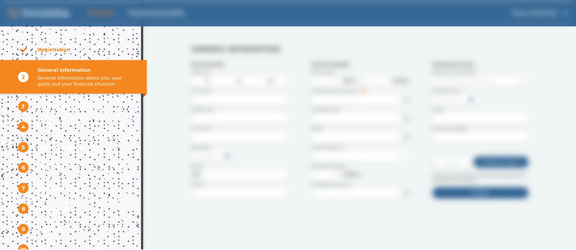

Here's what I'm talking about:
This was sent to us by one of our testers. Apparently it happened to at least three people, we know one of them uses Chrome on Windows.
And here's what it's supposed to look like (and does look like when viewing locally):
Any ideas what could be the reason?
Joely10623436
May 7, 2021 1:45 PM UTC
Please Ask the user/tester to update his Browser or switch to another one. Looks like a rendering issue of the blurred shape.

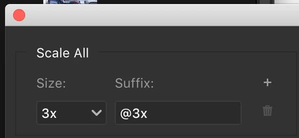

I usually export using the "save the web" method but that setting wont let me export 3 times the size. The reason I need to export 3 times the size is that when my cilent zooms into the XD, the image appears crisp. Therefore right now I am exporting using File>export as and change the setting to 3Xs.

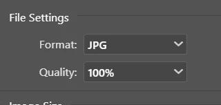

Thank you for sharing the details, Anna. I'd request you to please change the resolution to 300 and while exporting the image, make sure the quality is 100% as shown in the screenshot below:
Please try that and let me know if that helps.
