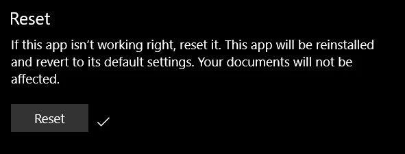

Amin Shazrin
July 2, 2018
I have a solution and it works for me ! First , you search your Adobe XD on Windows 10 Search Bar here , Right Click on the Adobe XD to go to "App Settings" :
Then you go to to Reset section and Click Reset Button like below . Start the app again , and it works !
July 2, 2018

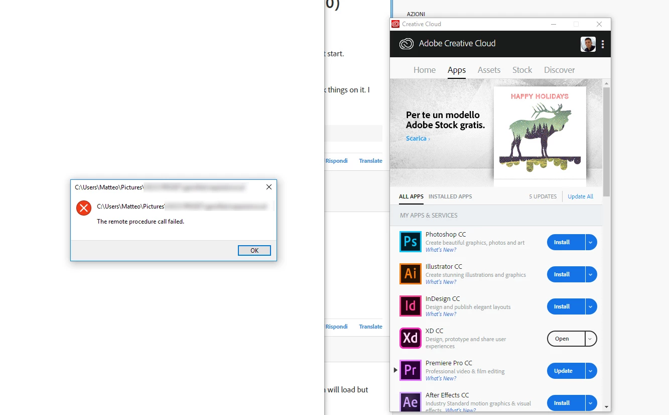

MatteoMasciotti
December 11, 2017
I am experiencing all of the situations described in the previous posts. I tried all the possible solutions including,
uninstall my cc, clean any possible residual files with the cleaner cc app, checked my windows 10. Nothing seems to work fine.
I can only use xd after I restart my computer, then if I save and try to load a xd. file it won't open at all.
Any suggestions? Did anyone findd a working solution to this annoying problem?
