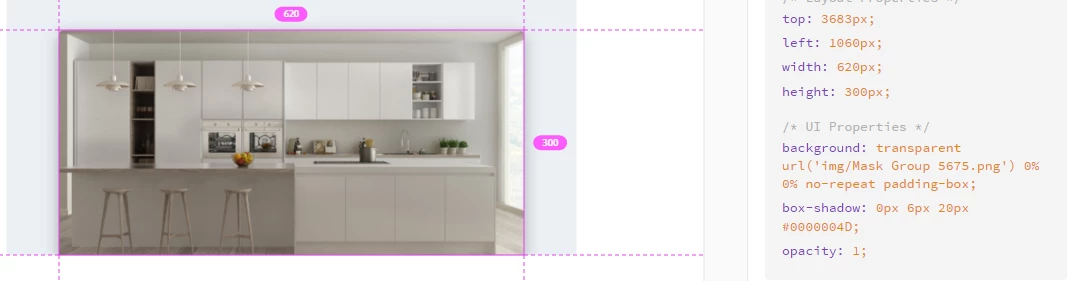

Mar 23, 2023 7:07 AM UTC
Tezarty
It's worked! also it's very easy...
attached image for the same
