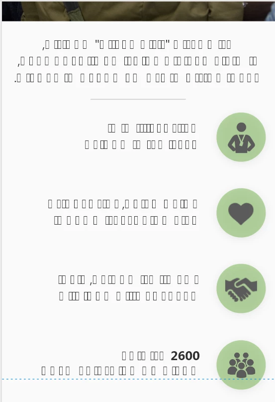

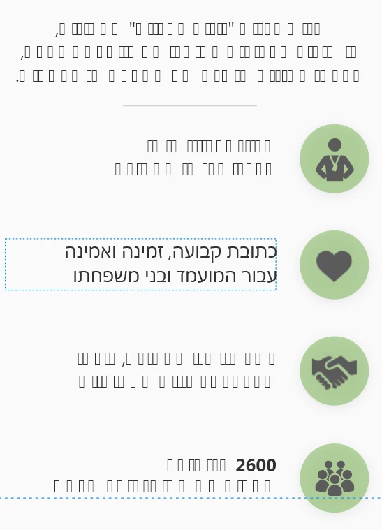

Hi, as you can see in the images below, letters appear like blocks instead of the "SEGOI UI" font.
While editing the text, you can actually see the font! but that won't last after the editing.
This project is very important and I hope someone here will be able to help me through.

Hi Ofek @         Ofek5776
I opened your files and realized you have used Hebrew (RTL language), well, XD not supporting RTL so very good, at least not as good as it should have, also, the squares you see usually shown when a glyph in a font is unsupported, unfortunately.
You can read this article about the usage of SEGOI UI font & Vote for Feature request here.
Meanwhile, you can try using more popular fonts like OpenSans which is an LTR & RTL font like Open Sans Hebrew.
Hope I helped even a little, you can contact me if anything else is needed, will try helping you...
