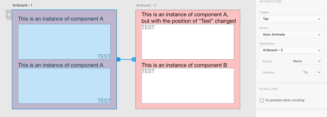

thank you for the fast feedback, but this doesn't really help me sadly.
I can get the animation you described to work just fine, just not with 2 separate components.

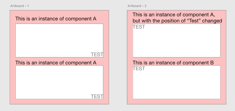

I have 2 components, their structure/objects/names are exactly the same, the only difference between component A and B is the position of the Text Object:
Here is a picture of the 2 example artboards with the components:
This is the way the animation is set up:
As you can see, the top animation with only one component is working just fine, but the animation which is supposed to switch between 2 different components (component A and B) is not working, but using the fade in/out transition instead:
