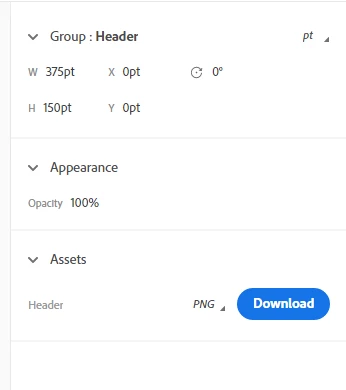

When I mark all of the assests on a screen for export, the colors hex code does not show up on the website that I share. When none of the assets are marked for export, the hex codes will show up on the site. I'm not quite sure why the hex codes are being removed once I have marked all the assets for export. Is there something I'm doing wrong here?

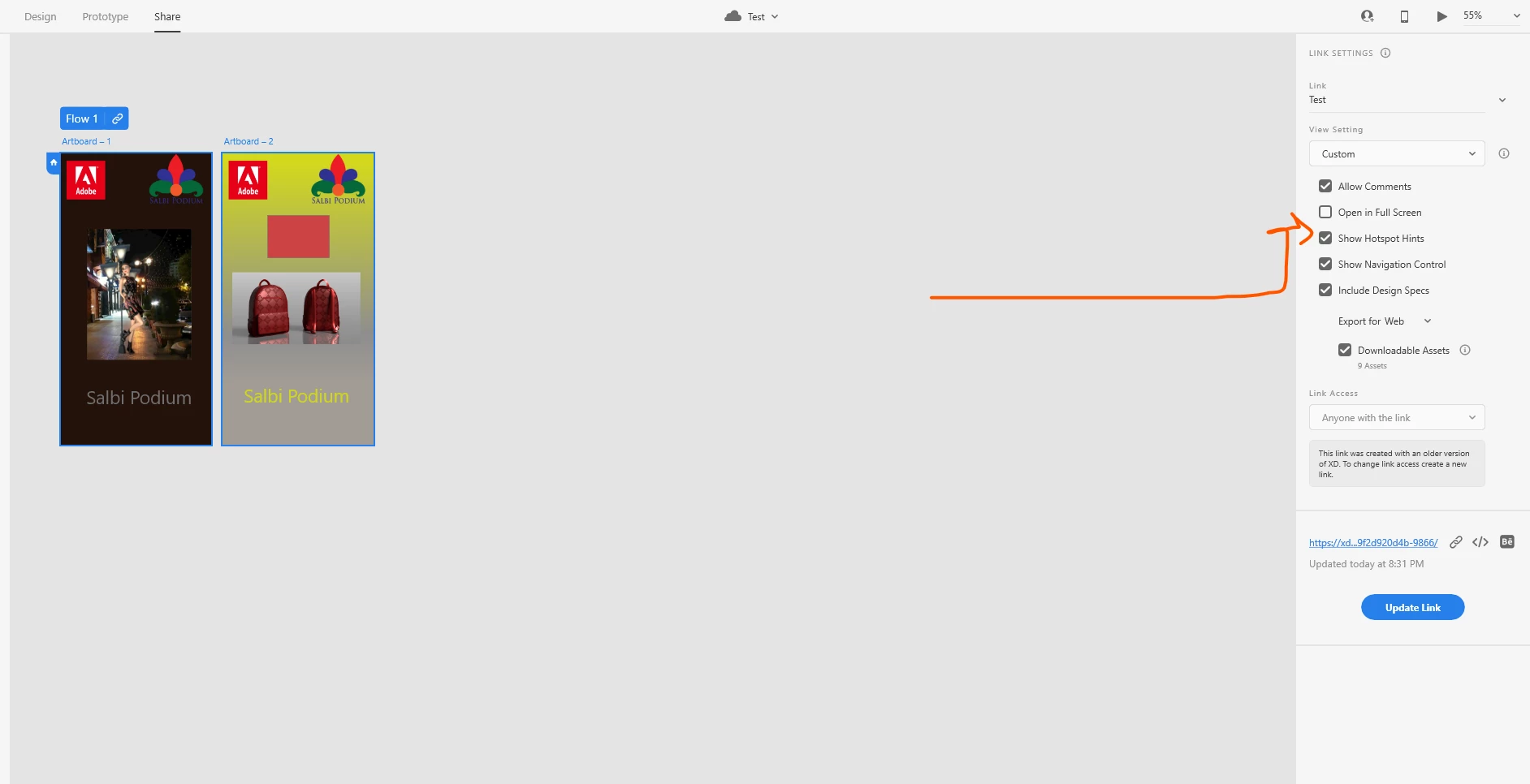

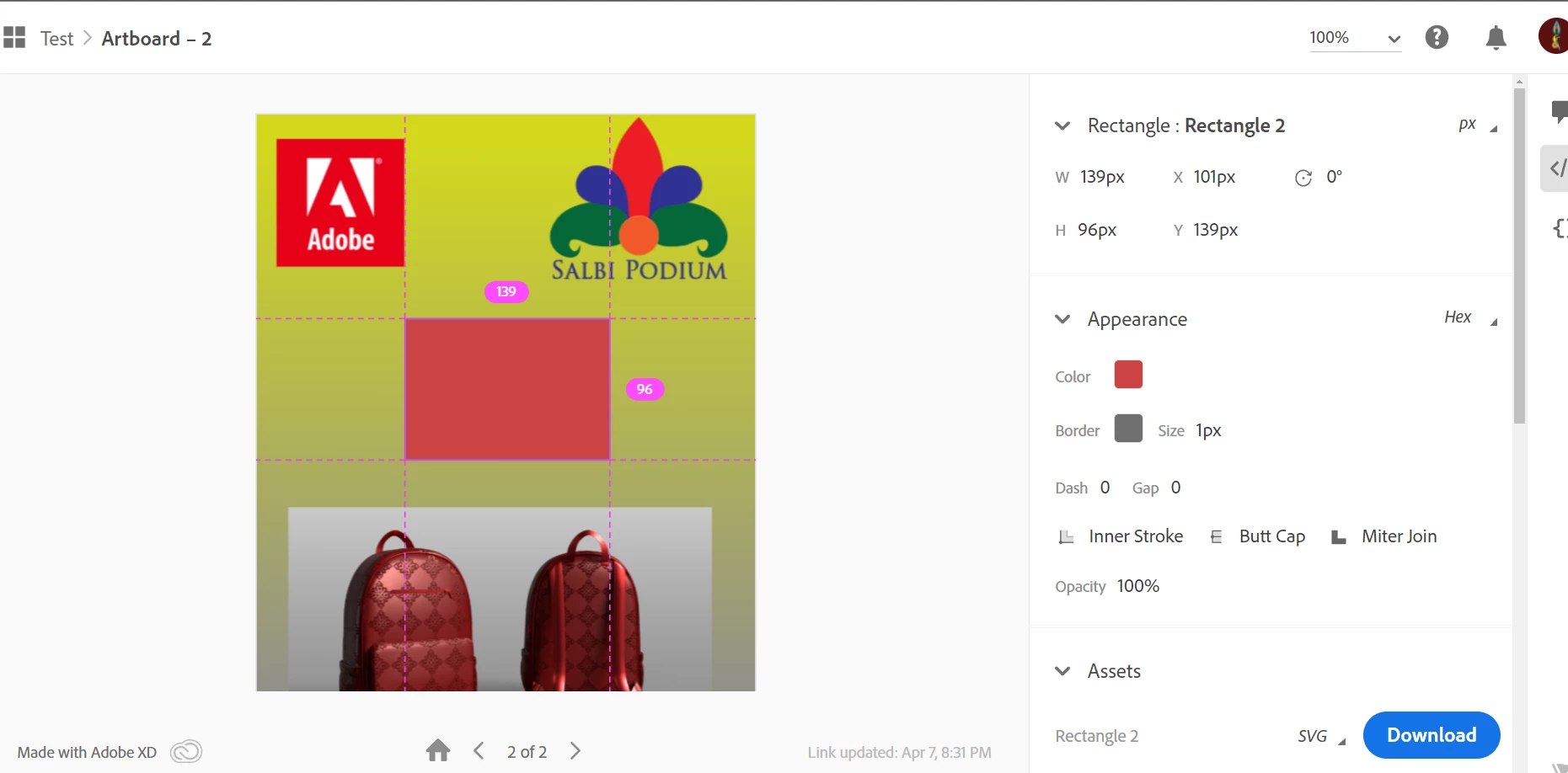

    I can see hex code after publishing with marked assets. Please check option to show hint code for preview befor sharing. May be that can be a reason

    I have done that, but it still does not work. Under appearance it only lists "Opacity". I also noticed that when I go to Custom, I do not have "Show Navigation Control" as an option. Would that cause any issues?

    I have figured it out. When I mark for export, I had been selecting the group. Once I went in a selected the individual parts of the group, it would work. I'm glad this works, but still a bit annoying that I can't select the group and still have this feature. It's much more tedious to go into each group and select each part of the group. Is there an easier way to do this?
