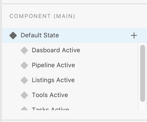

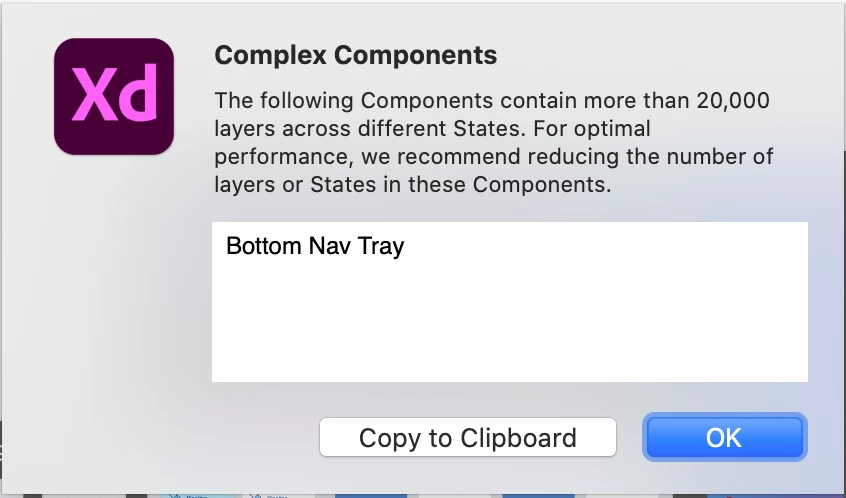

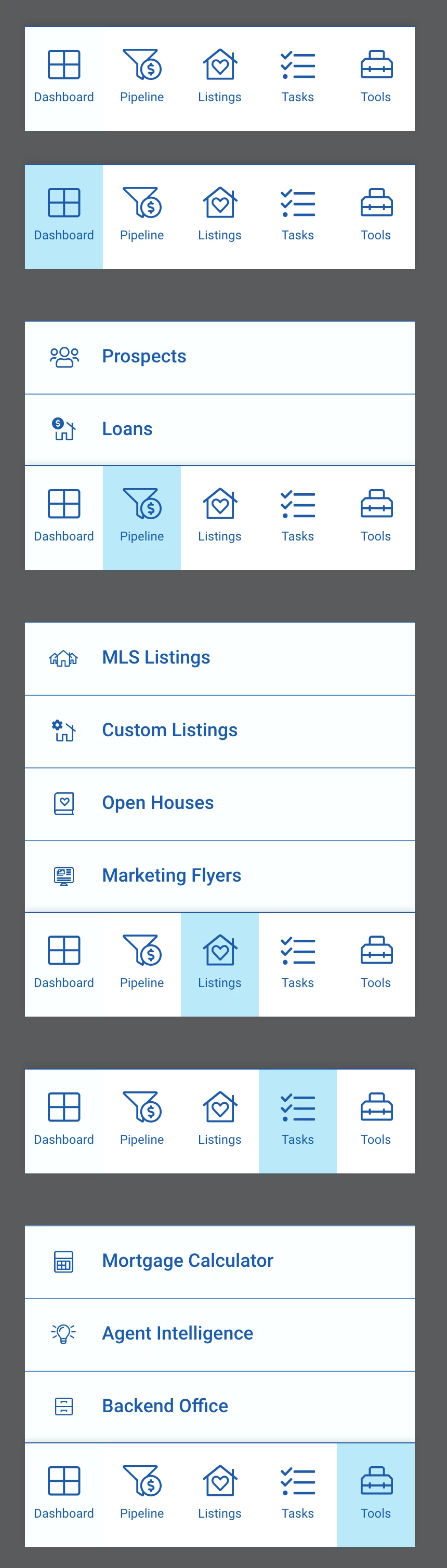

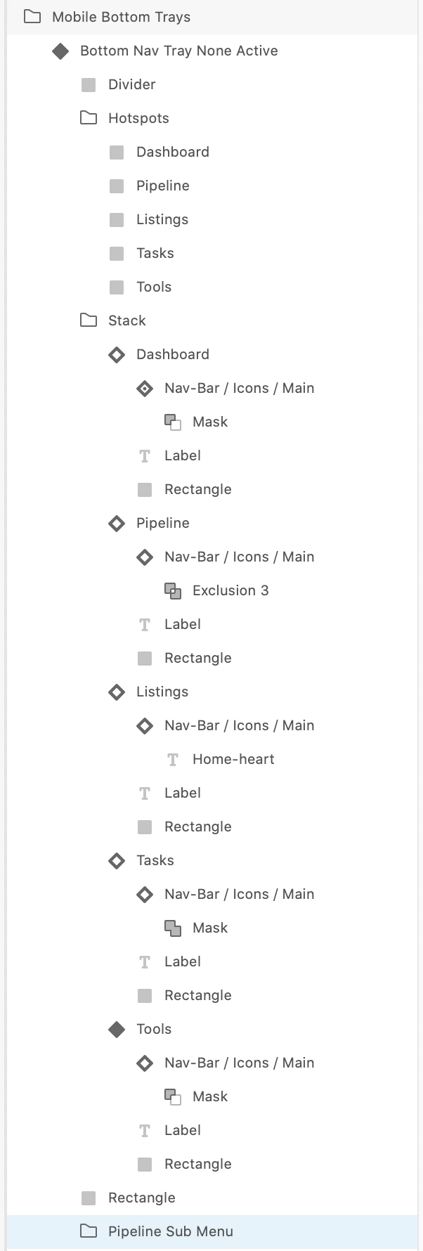

My team and I have been getting a message when we first open our files that we have a component in our shared library with more than 20,000 layers. This component that's called out has nowhere near that amount of layers, however. It has a little over 100 layers including all of the vector icons and masks.

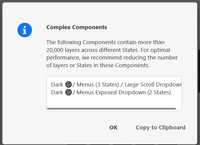

May 16, 2021 2:48 PM UTC
Posted on May 16, 2021
I still get this issue by simply trying to open Google provided Material UI Design template's Dark Theme. (Attached Here).
So if Adobe engineers need to reproduce this issue, that's the easiet file to begin diagnosing the issue. I am not sure whole fault this is though. It is also Google's falut?
