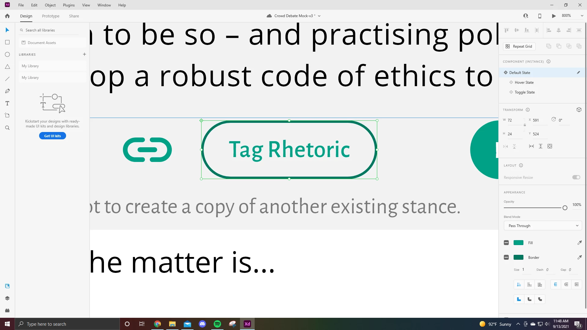

I am having a problem where a button is moving position from one state to the next.
For example, a button is at location X: 10 Y: 10 while in it's default state; but in it's hover state it nudges to X:12  Y:10. The button would then change position again to X:5 Y:17 in it's active state.
The button consists of just a rounded rectangle and 1 word of active text.
This is happening with more complex components as well, and the position is changing by hundreds of pixels in positive and negative directions.
