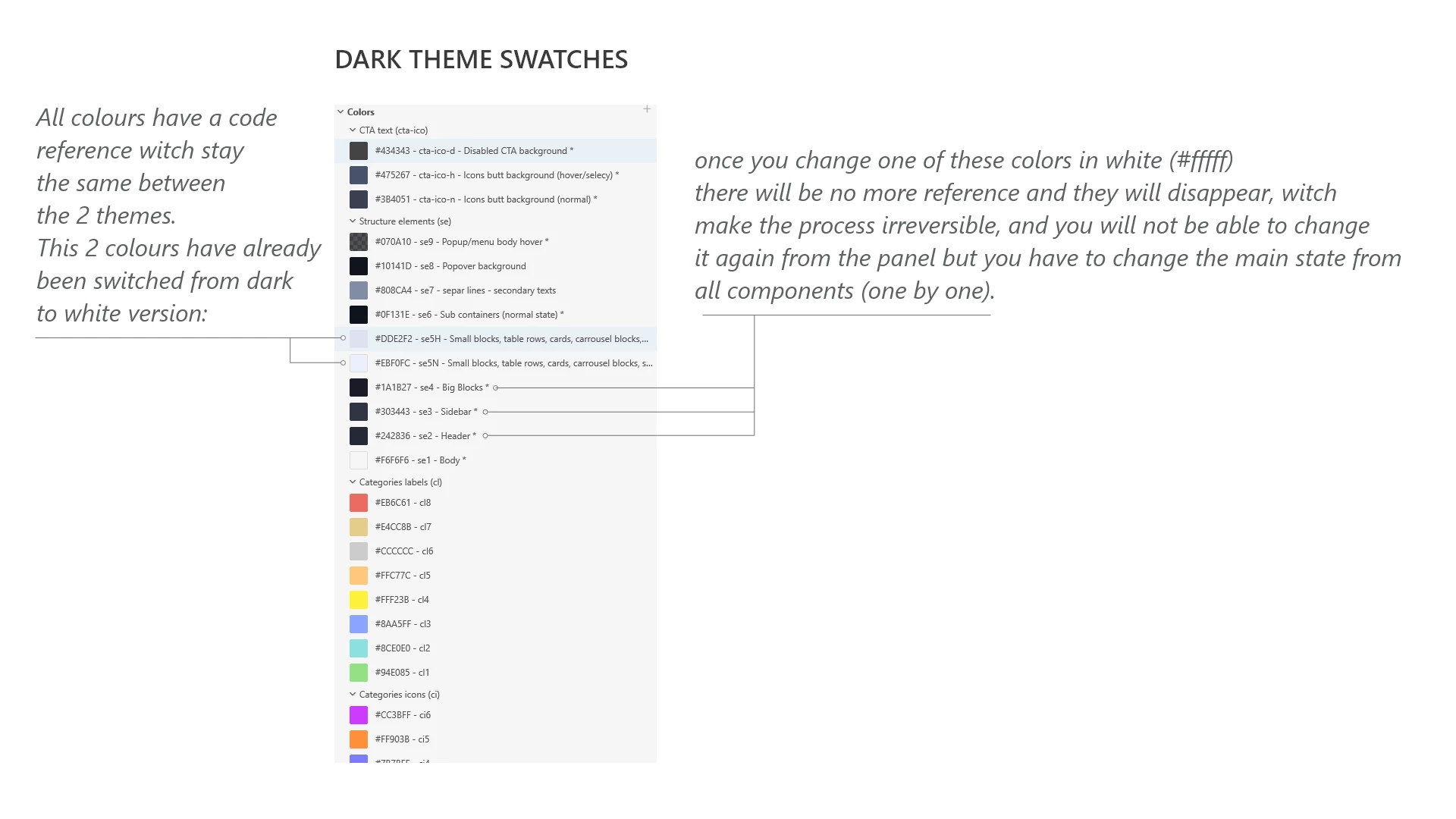

The issue is that when I edit these colors in white, they will disappear from components palette and there is no way to keep them. This is quite annoying... about text for exemple, it will not be possible to change them with a single color palette edit and all the components and text wich are in white, will be no longer editable via the color palette assets.

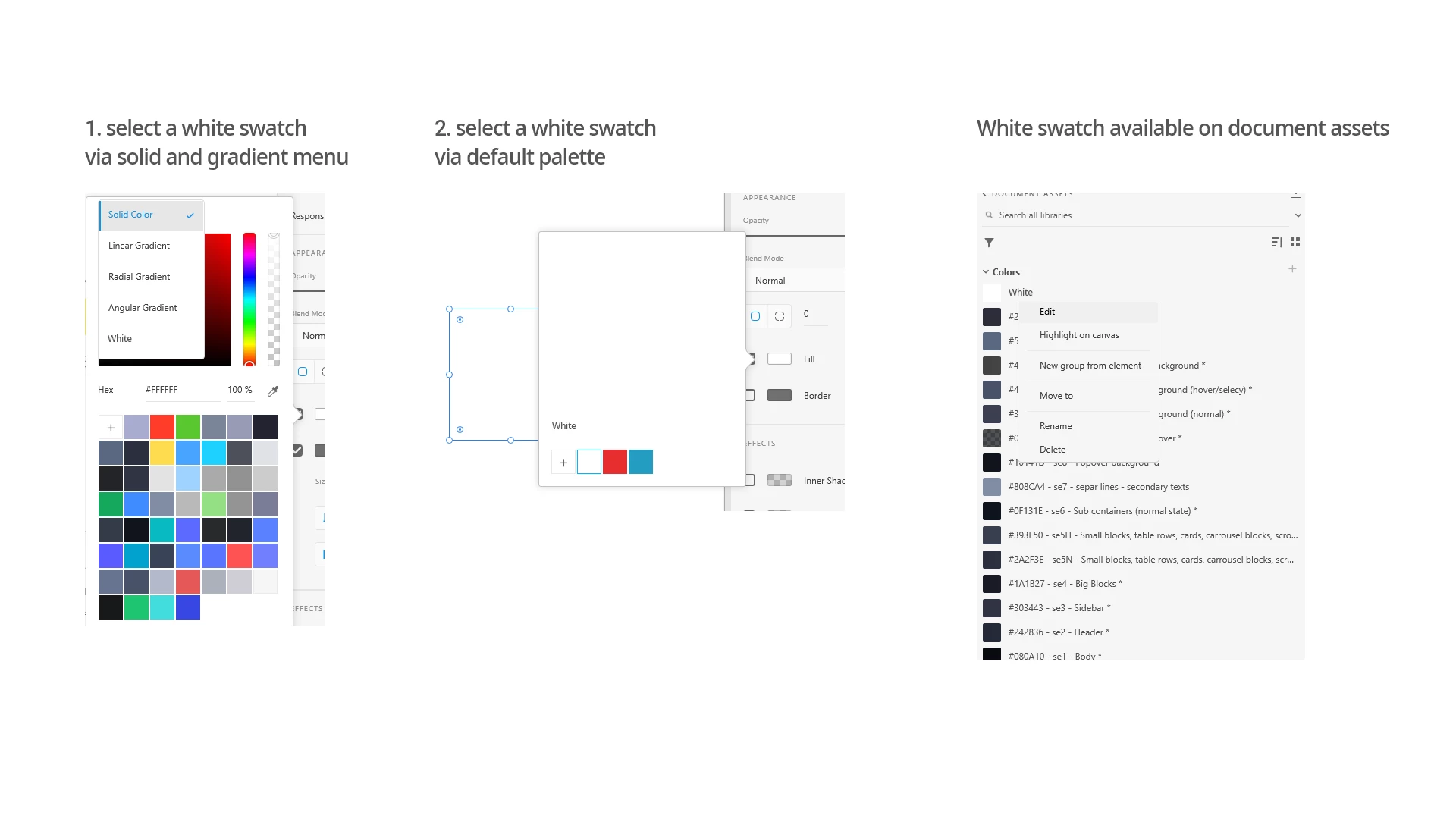

I'm wondering if there is a way to have so a white color which can be interpretated as a custom swatch by Adobe XD, just like Adobe Indesign do with "Paper" swatch in order to differentiate this from white.

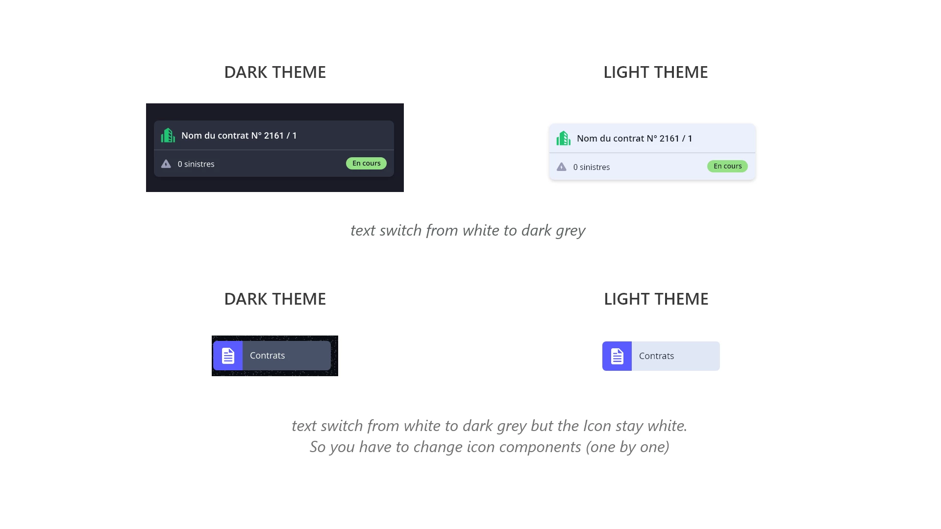

    I do know the plugin you mention, by the way it is very important to me to have a white swatch because you will always have the color reference and expecially for text, it will be very useful, also while you have to create a web UI kit and work in a team. Imagine having all your dark components text and some other elements like icons in white and then you have to switch white text to a dark grey but not the icons; you could still have a swatch reference and keep it in the assets. So in order to better comunicate with developers, you could always have a swatch with his own code and his HEX reference and easly show what color has to switch beetween a theme to another. Of course, you could change the main state of components but then you have to do this on all components.

    I post an attachement to show you and community why (in my humble opinion) not having a white asset swatch is not optimal.

    Just to make my self clear, please see the attachement of what I think could be helpful in order to control and edit all elements in white color. And if there is a way to get a similar result do not hesitate to let me know.
    Thanks
