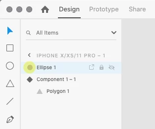

Hope this is not stupid: but why isnt it creating symbols across the art board even though I've added it as a component?
Thank you!
Correct answer Peter Villevoye
You can do it as Jangriti described, above.
You can also draw elements and drag them up or down, into or out of the Component (double-click to collapse/open it) in the Layer panel. So then the new element also becomes part of the Component.

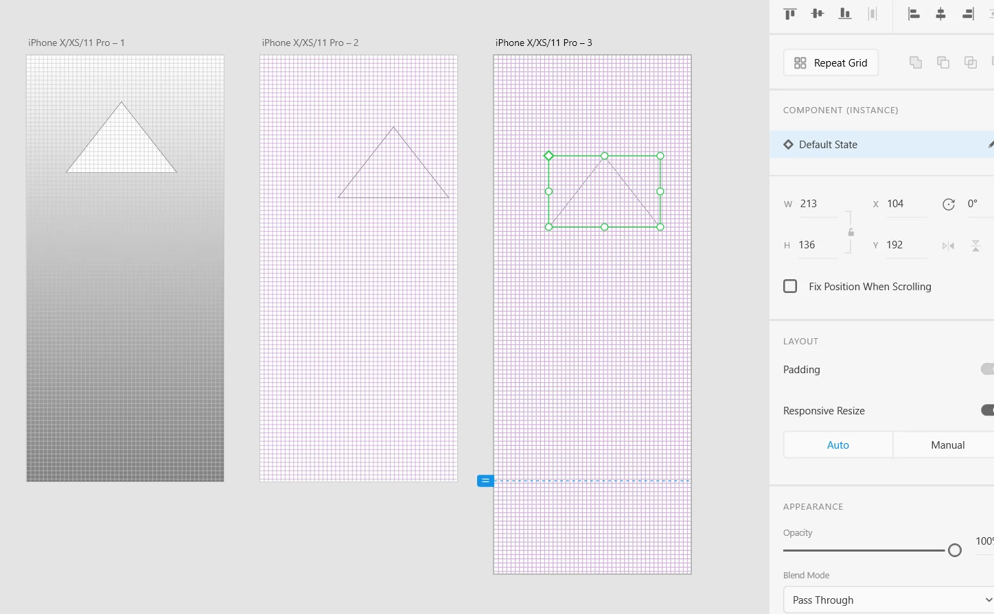

April 5, 2020
Hi
I'm trying to see once i've created the triangle as a symbol or component, if i were to create another triange within the triangle, would it replicate across the 3 different art boards since I've add it as a symbol/component?
April 6, 2020
Hi there,
My understanding of your query is that you have created a triangle and made it a component (say component 1 ). You are using instances of the same component in different artboards. Now you want to add a small triangle inside component 1 (i.e the triangle) and you want it to reflect in all the instances of component1. If my understanding is correct, then you can follow the below steps to get the desired result:
  1. create a triangle in artboard1
  2. make it a component by clicking on the "+"sign near components in the assets panel
  3. drag instances from the component  to other artboards (say artboard2 and artboard3)
  4. go to assets panel and right click on the component. The contect menu will appear.
  5. click on "edit master component" in the context menu. You will be able to see that the master component gets highlighted.
  6. Double click the master component to go to edit mode.
  7. add the smaller triangle in the master component(which is in edit mode). You will be able to see the newly added triangle inside the previous one in all instances of the component.

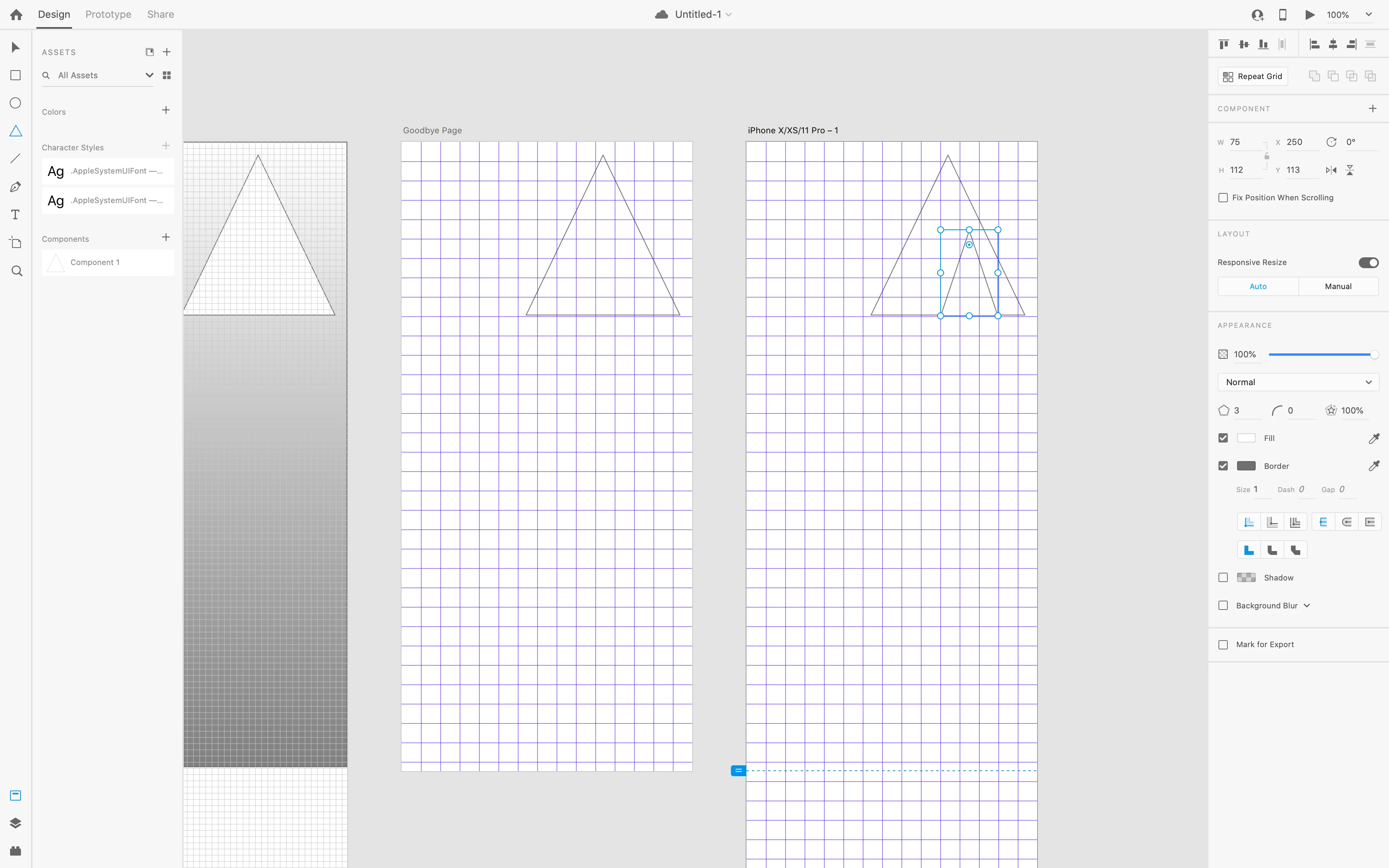

Peter Villevoye
March 27, 2020
As far as I can judge from your screenshot, you're simply drawing another triangle with the polygon tool. The Component you created (formerly known as a Symbol) is in the Assets panel, right next to it ! Drag it out to the artboard and you'll see the element, with a green outline, indicating that it's another instance of the Component. Does that help ? Otherwise you need to be a bit clearer on what you're doing...
