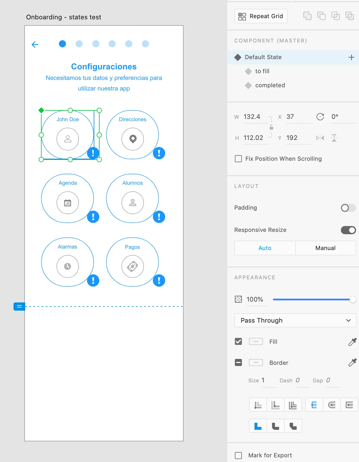

I'm working with states.
I have 6 tiles fitting in a mobile screen. default state

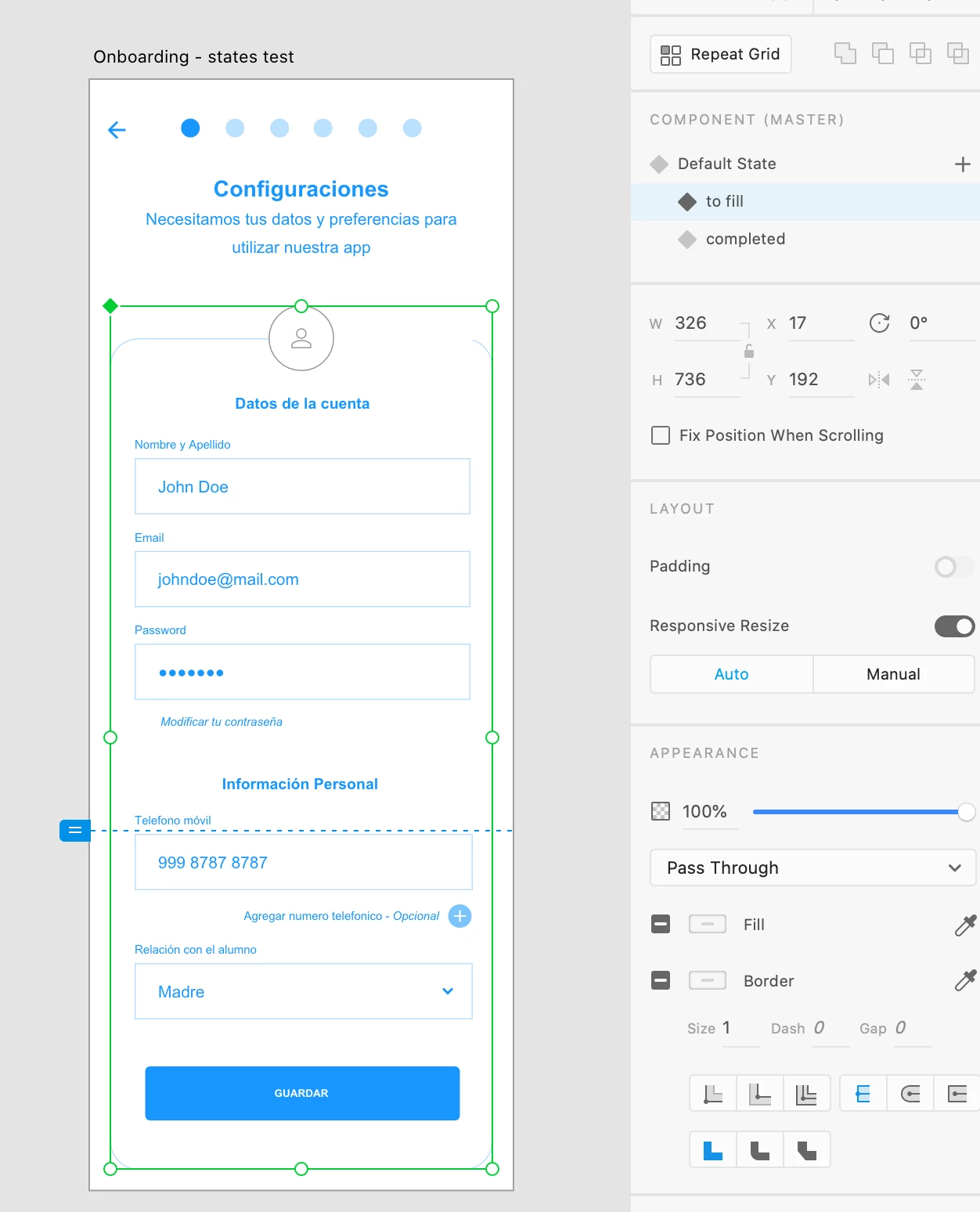

Second state for one tile is bigger than the screen and needs scrolling.
and 3rd state should go back to the viewport size, to the top of the screen.

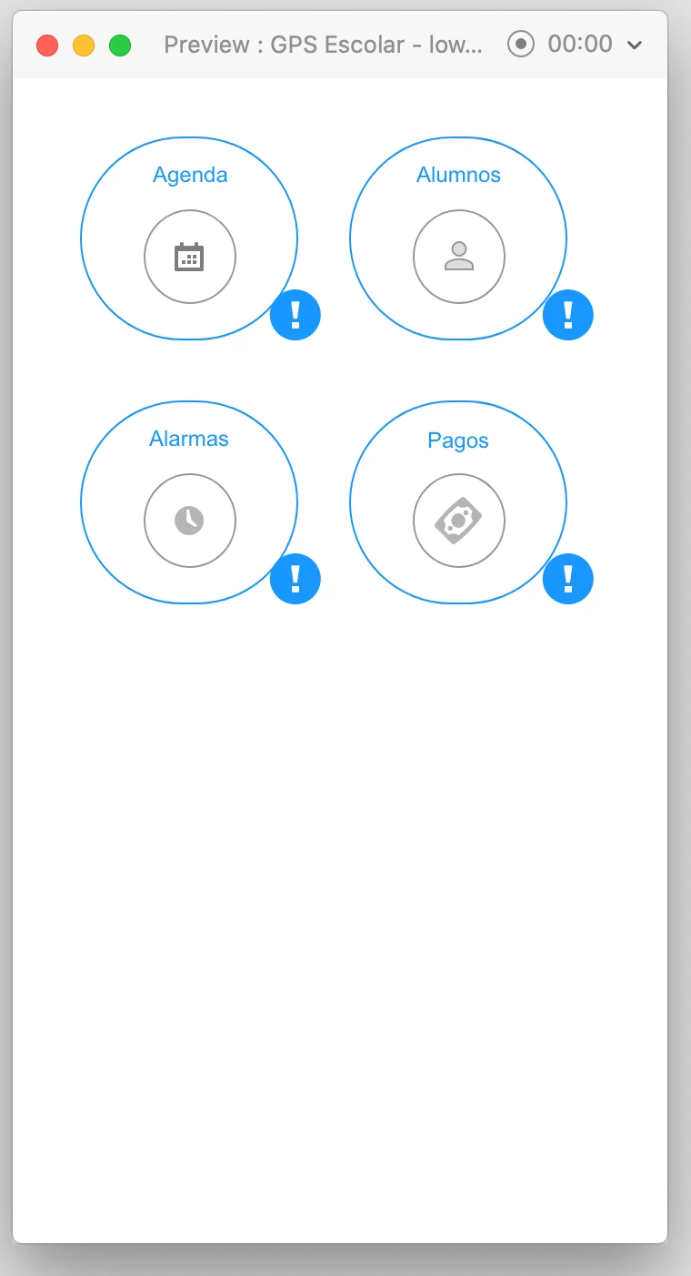

But autoanimate doesn't allow it. I'm stuck at the bottom of the scrolling.
If I keep the viewport size of the artwork I can't scroll the form.

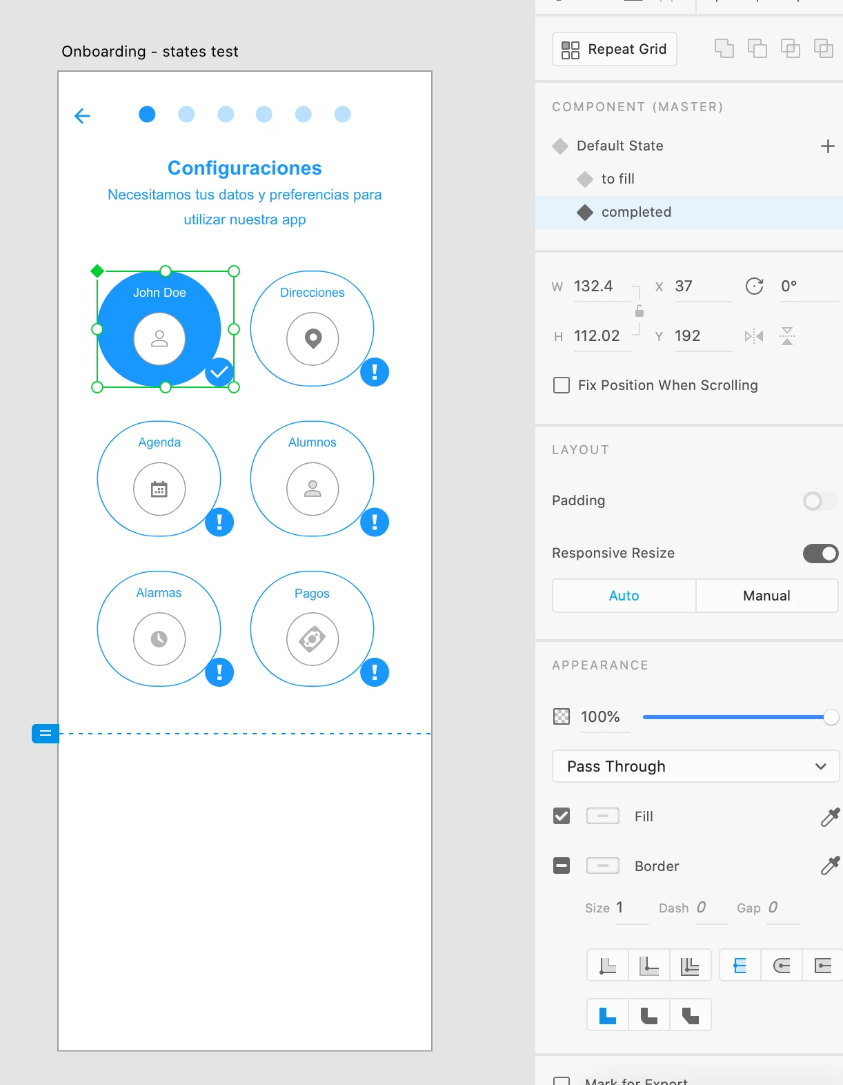

The problem I have encounter is that now, the component it is preserving scrolling position. See Image #4.
After filling out the form I lost sight of the component I was animating. I need to see the change in the state, image #3.
