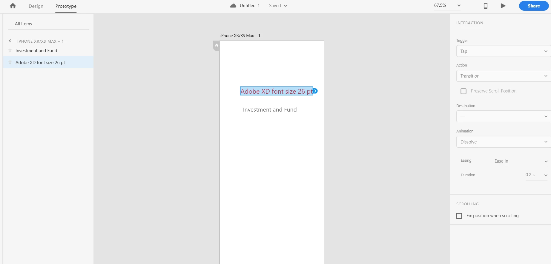

Thank you for reaching out. Based on what you said, it looks like you are trying to fix the position of the components by using the "Fix position when scrolling" option in Prototype mode. I tried to reproduce the same at my end and I have found that we need to select the component of the artboard to make the fix position option visible. Please see the screenshot below: -

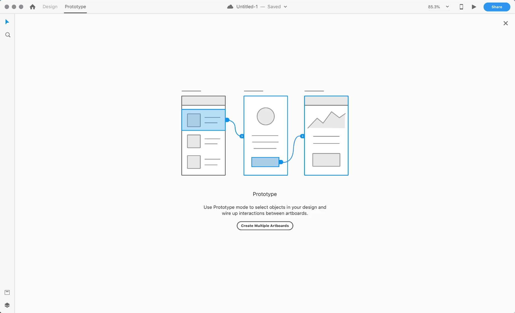

You can access the fix position checkbox even if you have a single artboard. When you switch to Prototype mode with a single artboard, you probably see an onboarding message which say - "Create Multiple artboards ... "
Simply dismiss that by click on the close icon in the top left corner. After that you should be able to access the Property Inspector in Prototype Mode.
