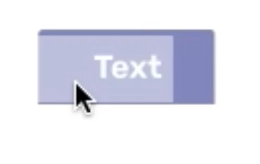

so ive spent all afternoon messing with this and cant understand why its happening. Auto-animate between hover state and toggle state on a button keeps flashing a white square. The strange thing is that it doesnt happen when toggling again from the hover state to the default state. I can only think that it has something to do with the interaction between a hover state and toggle state. Any help would be grand.

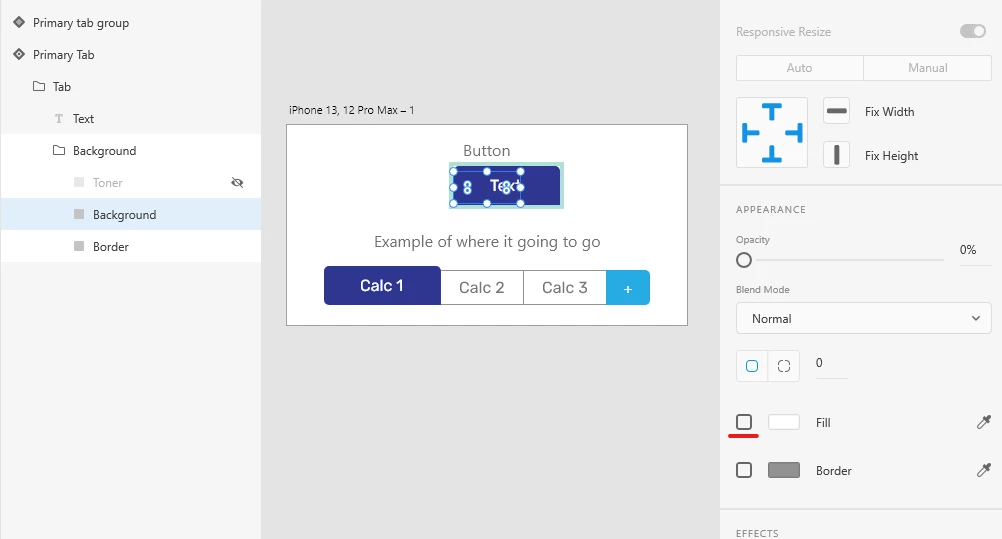

    So, to fix your issue, uncheck the fill color of the "Background" layer in your toggle state.
    Problem is that from Hover to Toggle states, your background goes from 100% opacity and blue color to 0% opacity and white color. Because some shortcomings of Xd, the fill color instantly switches to white, while the opacity slowly goes to 0%. At the same time the border becomes the big blue rectangle, so at some point the background is on top of it, is completely white, but has not yet reached 0% opacity, which is where you see the white "flash". If you disable the fill color completely in the toggle, it goes away as soon as you click and you don't see the flashing.

    You my friend are a genius. Thank you so much. This would of kept me up all night.

    Chris W. Griffith
    Mar 23, 2022 5:23 PM UTC
    I recorded the interaction and can see it. Maybe seeing this image might give a clue to an element that exists in the states?
