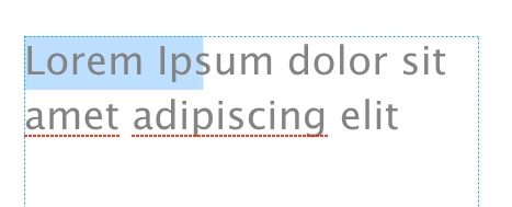

    This is what happened trying to work with the Adobe Font version, whatever the parameters I fiddled with:
    Selecting the text field, the text appeared:

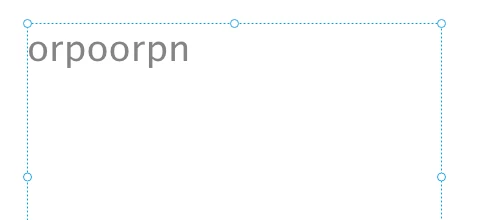

    Deselecting the text, this -- enigmatically -- happened:
