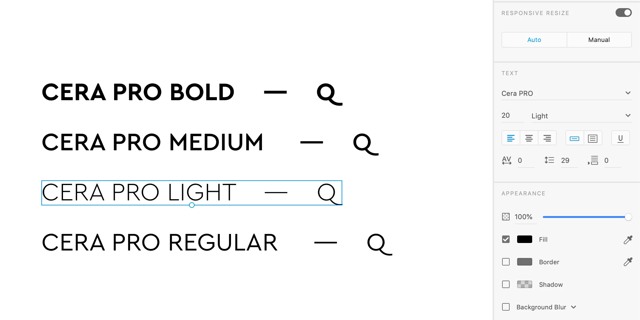

Yep, I think the problem I'm having is the fonts are installed and appear to work.
So when I open that file I get 1 missing font. I can change all 4 lines to a different font. Then I can change them back to the 4 weights of CERA PRO and it works/lets me change them to all weights - including 'light' which is the so called missing font. Then if I close the document and reopen it says it's missing again.
Even though it works, maybe there's just a problem reading this font file?
I'm pretty certain the font works as 'light' isn't greyed out and from the attached screenshot you can see it displays its distinctive 'q' on each of the weights?
Pretty peculiar!

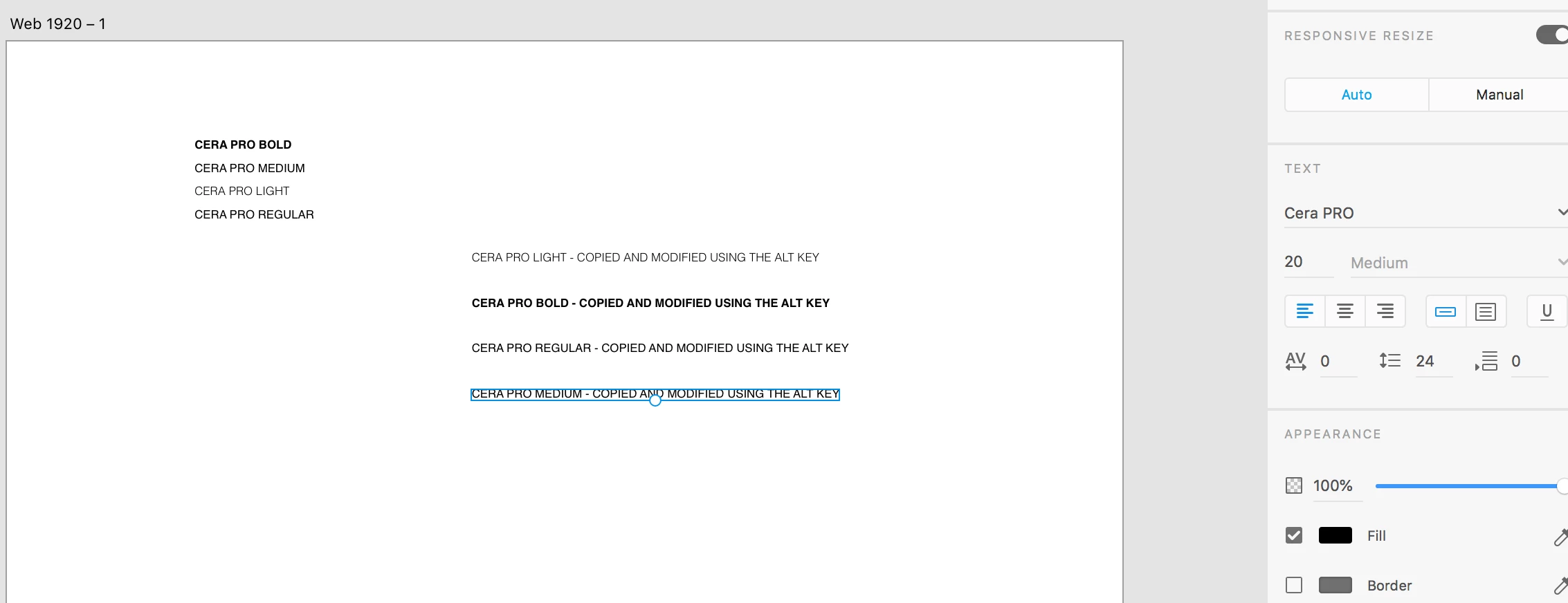

Preran
February 8, 2019
Thank you. I opened your file, click on the message 4 Fonts Missing, and was asked if I wanted to copy these to a clipboard. I clicked yes, after which I used the alt key to copy text in the artboard and modify it. Doesn't this work for you?
Preran
