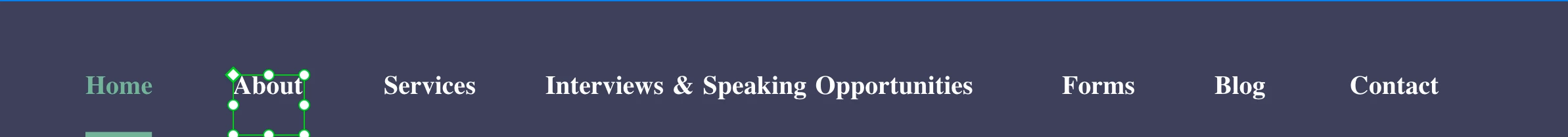

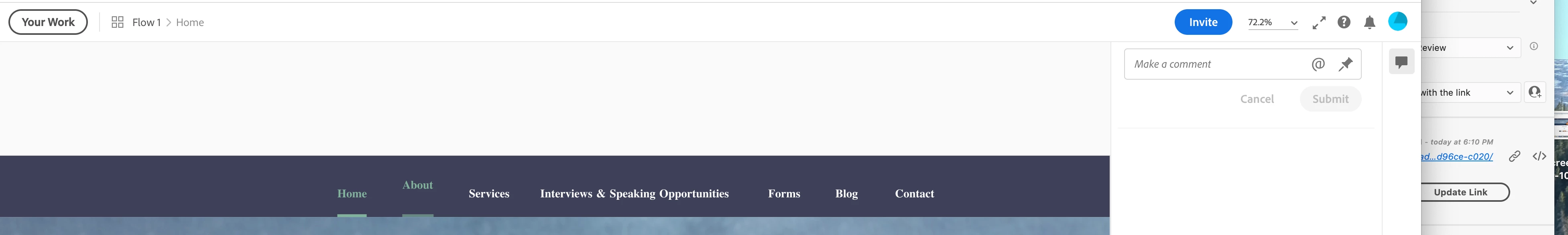

    Oct 27, 2020 11:31 PM UTC
    Hello -
    Yes, I have XD version 34.1.12.9.
    I'm setting up a nav bar so that each item has a default state (white text, 0% opacity bar) and a hover state (teal text, teal bar). I'm attaching screenshots of what these look like in XD ("Nav bar.png" and "States.png").
    When I preview via the Desktop Preview, everything performs as it should.
    When I preview via the Share Link, these nav bar items jump up vertically. They only jump up briefly, and then go back to their correct location shortly after. They jump when I hover over them in the first place, and then they jump again when I move my mouse away.
    ("Jump.png") Here, you can see that the "About" nav item has jumped vertically from the others. I'm trying to get it to stay in the same location, just change colors.
    I'm using Chrome to preview the Share Link.
    Looking forward to any thoughts you have on this.
