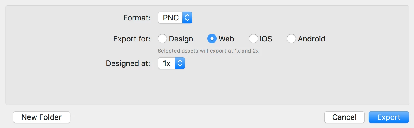

Correct answer Kenneth Kawamoto
In the export dialogue box:

May 14, 2019
If you select the "Web" radio button for the "Export for:" in the export dialogue box, your assets will be exported at @2x as well as @1x

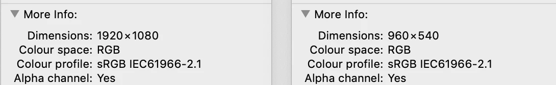

May 14, 2019
Thanks for the reply, but that doesn't seem to work Kenneth.
@2x is 1920x1080
and 1x is 960x540
Am I doing something wrong? the working artboard in XD is 1920x1080
I have a workaround, that is exporting as a PDF and then re-rendering in Photoshop.. But just seems little odd, unless I'm doing something wrong...
Kenneth Kawamoto
May 14, 2019
Have you set the "Designed at:" to "1x"?
