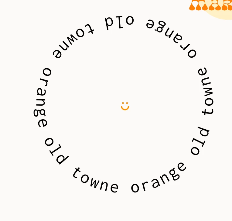

How to auto animate text rotating in circle?
Does anyone know how to auto animate this text to constantly revolve and loop in a circle?
