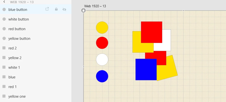

Hello! I'm designing an interactive color index.
I have 6 rectangles in four colors, and the idea is to activate/deactivate these shapes by clicking the button that matches their color, and creating multiple color combinations by having more than one button activated at the same time.
My only problem is that the shapes must mantain their original layer order:
the shapes are stacked in a way that makes it impossible to create a component for each color, because it would group all the shapes with the same color together, and compromise the order above.
I've tried making the whole thing a single component and prototyping each color inside it, but it didn't work.
is there a way to make this sistem work?
thanks!

    Hi Clara 🙂
    If I understand correctly, you want to make it so that when you click the red circle for example, the 2 red squares disappear or appear.
    Right now one element's trigger can't affect another element or component's state or style on the same artboard.
    Since they are at a different "depth", the only way to do this right now would be to make a component encompassing all the elements on the page, or multiple artboards. In both cases, you will need to make one state or artboard for each possible scenario (of which there will be like 36 or something), and wire them all up, which would be rather complicated.
    I would suggest just showing how it works with maybe 4 combinations, and the programmers will do the rest 🙂
    Hopefully that brings more clarity.
    Cheers!

    Hi Clara 🙂
    Cheers!

    Hi Clara,
    Thanks for reaching out. I tried achieving similar animation and the approach that I took was to group the same color shapes individually and then making them a component. So if there are 4 colors(including no fill) then there will 4 components. Please try this approach and see if you are able to achieve it.
    Let us know if you need any further assistance.
