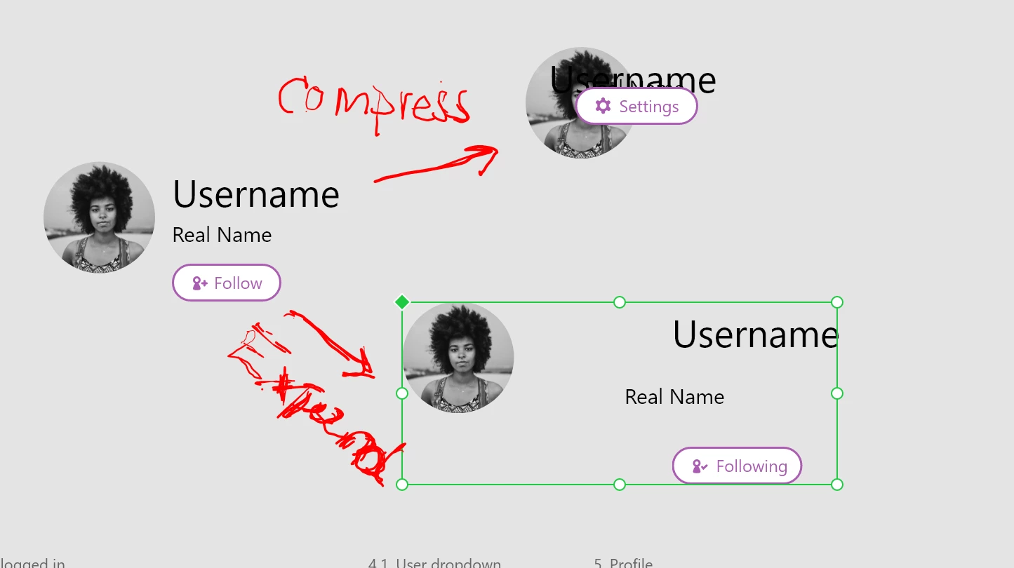

Hi - When I create a component made up of multiple elements (text, shape, etc) and try to make it larger or smaller, to fit on my artboard, the component loses structure and the items seem to move closer or farther away from each other instead of the component itself actually getting bigger of smaller.  I am very new to adobe so I hope this questions makes sense.  I attached a picture to reference.

Thanks for reaching out. Could you please try turning off the Responsive Resize option which is on the right-hand side on Property Inspector and try again.
Let us know if this works or if you need any further assistance.
