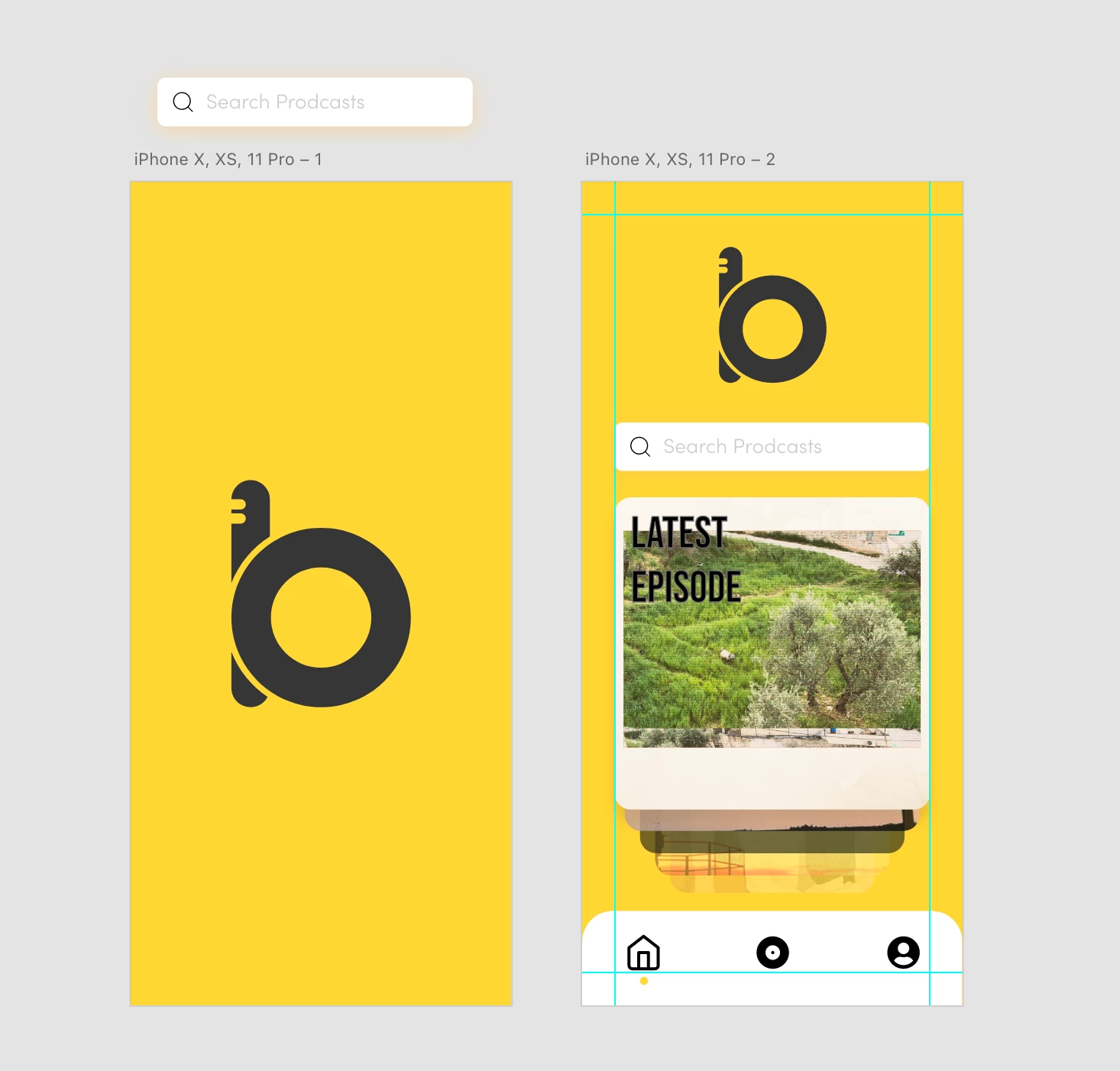

How to let XD know it's the same search bar to do auto-animate?
How can I let XD distinguish that the search bar is the same one in the next board to automate it? It doesn't work whatever element i try to move, it's moved to other artboards and work areas

Sorry to hear that you're having a problem. Is this for auto-animate?
If so, first make sure both search bars have same name. Next, drag search bar to the first artboard and setup auo-animate transition. Then you can move the search bar back off the artboard and (because of the transition) it will keep its association with the artboard.
