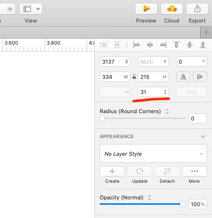

I don't want to use the distance functions, but rather enter the distances in numbers, as with sketch.
I just don't find this possibility anywhere.

Here is the function in sketch:

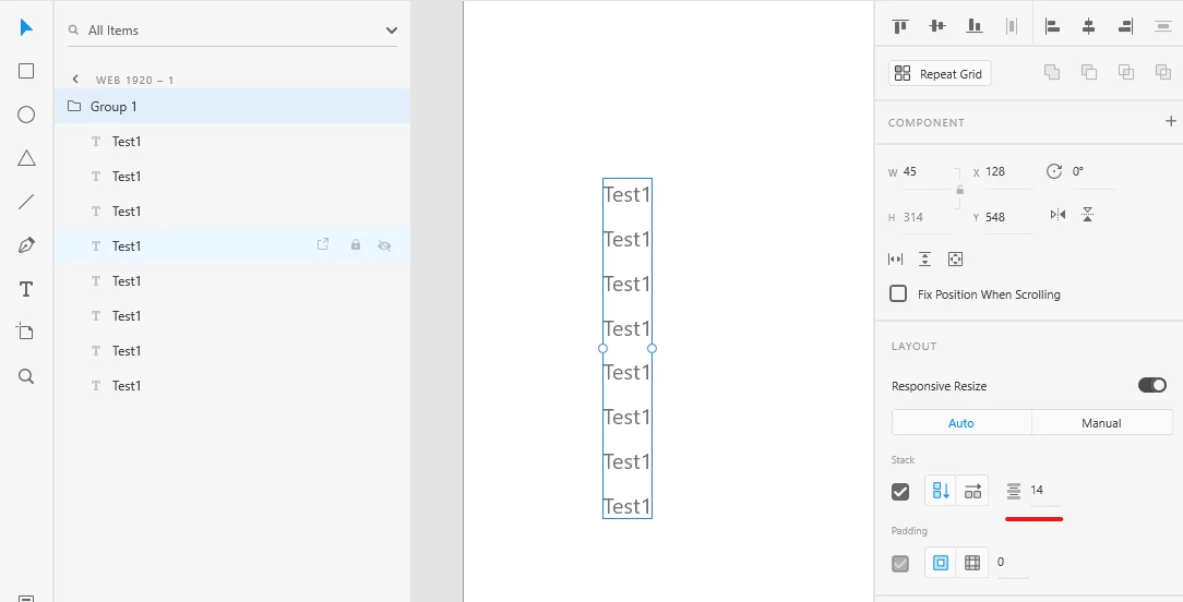

You can do this by adding the elements to a group, and turning it into a stack.
Then you will get an input for the distance between the elements within the stack.
