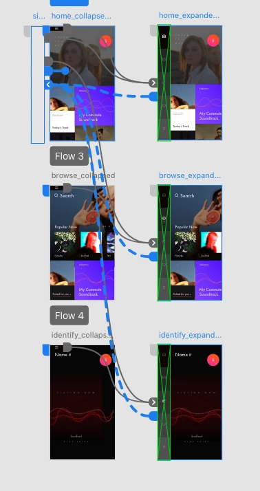

Hi, I am a beginner of Adobe XD, and I came across the problem while I was following alone the tutorial on Adobe learning page. I have a problem of not knowing how to close the side bar, I've already set the sidebar tap to previous artboard, but it didn't work. Please tell me what steps did I do wrong, and how can I fix it? Thanks

    Hi Meng-chi,
    Thanks for using Adobe Xd. Looking at the image you shared I couldn't understand all your links. But I do get what you are trying to achieve and for that am writing here some simple steps:
    1. Make the humburger menu bar a component(the one that I can see in your home-collapse artboard)
    2. Add a state to the component(make this state look like the menu bar you have in home-expanded artboard i.e bring the rectangle inside)
    3. Go to prototype mode, select the hamburger icon and click on the + in PI. select trigger:tap, action:Auto animate, destination: State2
    4. Now again select the component and in PI components(Main) select State 2. Click on + and select trigger:Tap, action:Auto animate, destination: Default State.
    Following these steps you should be able to achieve your outcome. Or else you can share your file , I would help you with it.

    Hi Meng-chi,
