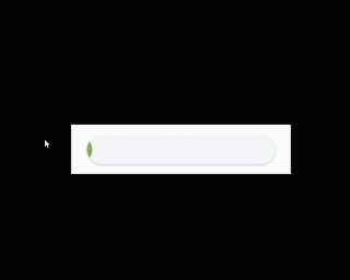

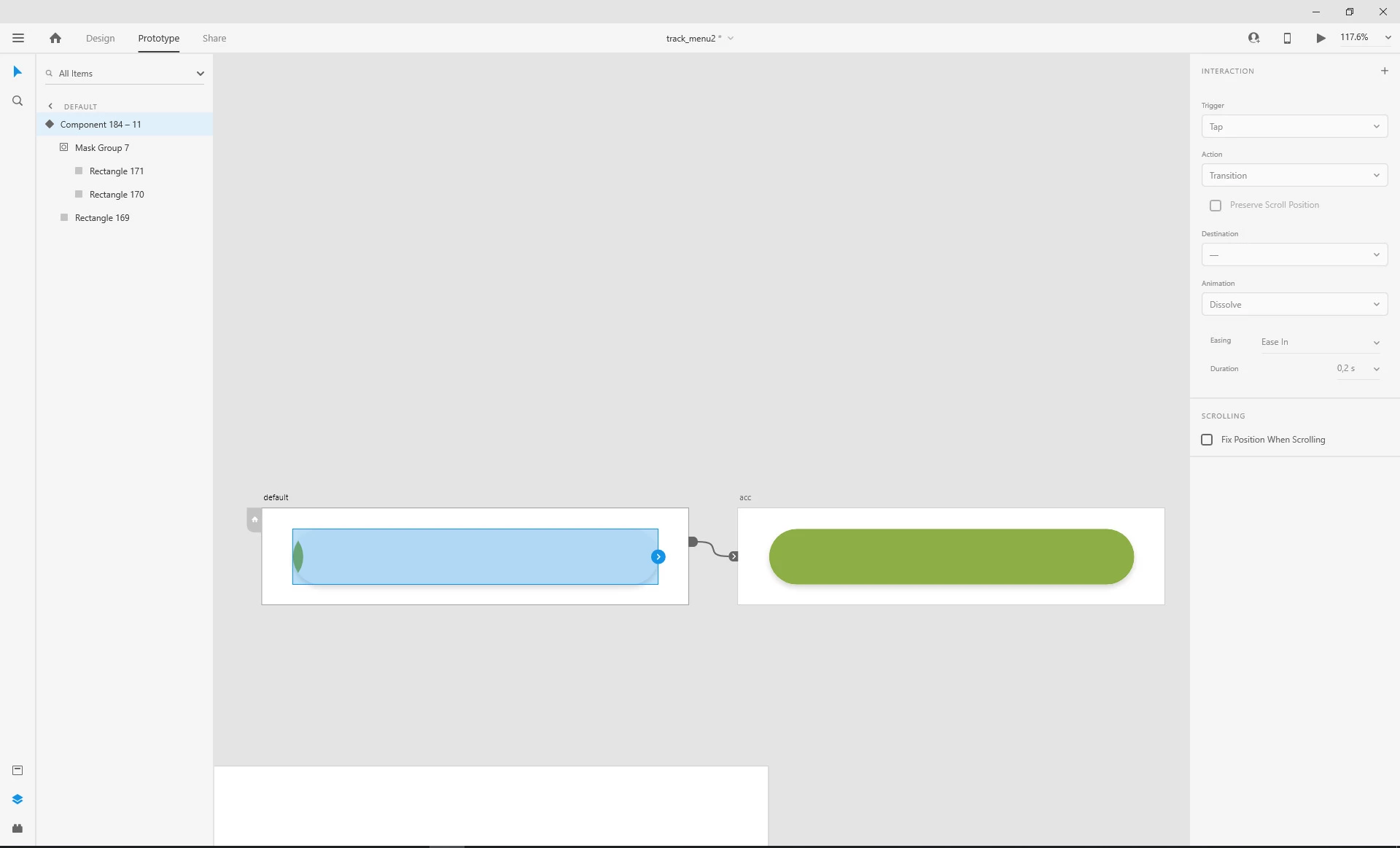

I've got another problem. I made a button with masking overlay. I want to drag overlay left or right to accept or decline something with this button. The problem is: my overlay move from left to right, but to start interraction i must drag to the other way.

Jan 14, 2020 11:21 AM UTC
You could use the Component State but the Drag trigger is not available so you have to use the Tap, which may or may not be a good solution for you.
Jan 14, 2020 11:45 AM UTC
Exactly, they're not good solutions. I know, I can move mask and let the green rectangle stay, but it doesn't let me move the button moth ways with different effect (drag right -green, drag left - red)

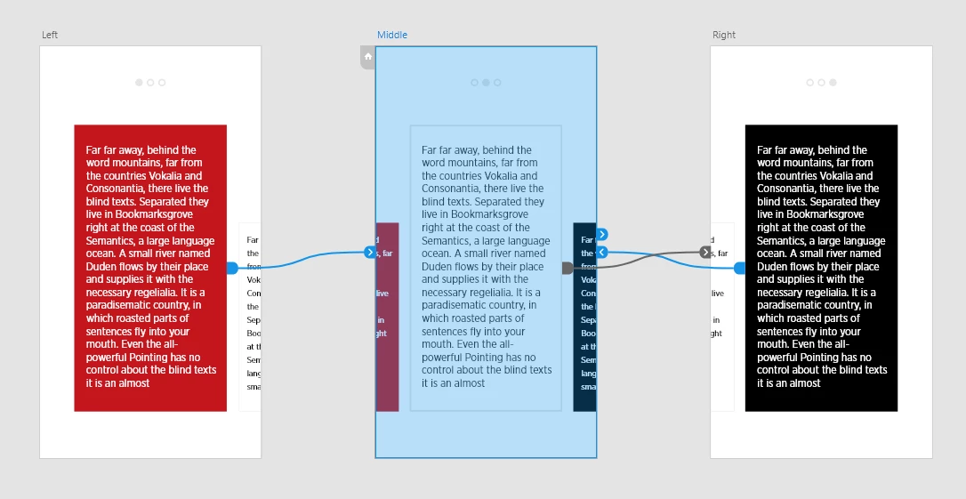

Just to be sure, cause I am having a similar challenge with the dragging gestures:
At the moment it's not possible to drag an object to two different artboards?
E.g.
Here I want to drag the object in the middle to left OR right depending on where you drag it.
It is working to the right but not to the left because I can't specifiy a second artboard.
Thank you in advance

Dec 19, 2018 6:54 PM UTC
Right now, the drag option works only in one direction (Right to Left)
Please vote for this feature request Specify drag direction – Adobe XD Feedback : Feature Requests & Bugs to stay tuned to the latest announcements around it.
