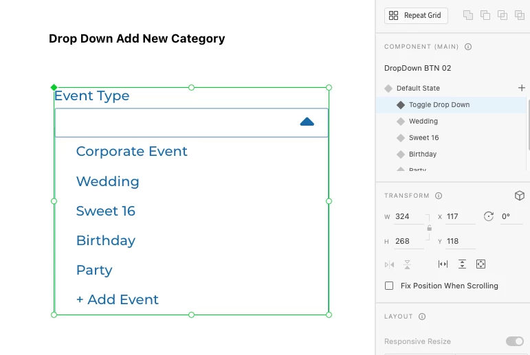

Hello I created a dropdown menu button and as of now I have 1 toggle component.
Im trying to set up to where when the user clicks on the "+ Add Event" button it will turn it into a Input where some can type in the event name. Here is an example.
The problem is because I have one toggle my component doesnt give me the option to create a 2nd toggle. Hoew should I handle this? If I click on "Create New State" instead of toggle then the user wont be able to close the dropdown menu like before when it was a toggle state.

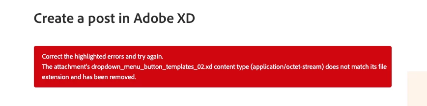

Hopefully I explained this correctly where it makes sense. I tried to attach the xd file but i keep gettings this stubid error.

    Hi Ruben, you don't need to use a toggle state. The toggle state is a quick way to make simple components with just two states. It's like the other states but with a two way link to the default state.
    What you need is an extra state where the dropdown has an input, so when the + Create New is clicked, it will point to that state.
    Since I already have your file from your previous thread, I set it up for you. Here's the file, and here's the prototype. If you want the input to add a new category, it will make things a lot more complex, so I'd end it here and explain to devs what needs to happen.
    Also, the forum doesn't like .xd files. You can upload to dropbox / google drive or any other cloud service and share the link here.
