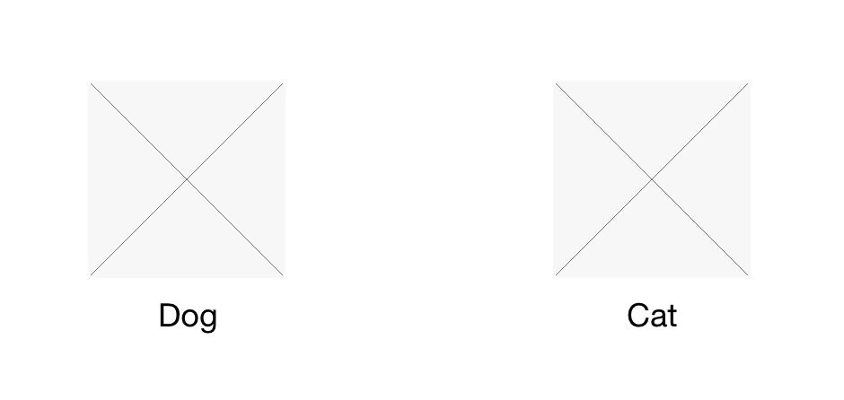

Hi, new to XD. I have 2 of the same size boxes side to side on the same page (they are components.) When one is selected and highlighted, the other should not be selectable or highlighted and vice versa. If you select Dog, you should not be able to select Cat. But both are selectable in my file and I can't seem to get this to work. Can anyone advise how to get this functionality? Thank you.

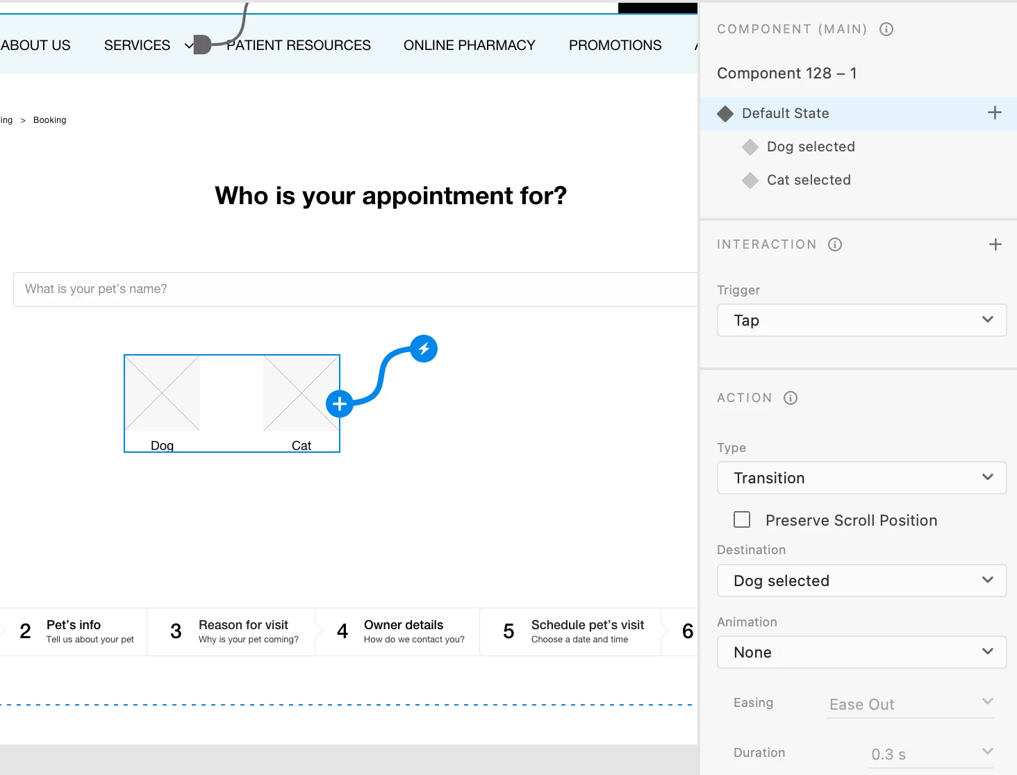

    Hey there. Unfortunately, in Xd you can't have one component change the state of another. The only option using a single page would be to have both boxes inside the same component, which will have 3 states:
    1. Default, where both boxes are unchecked
    2. Dog checked, cat unchecked
    3. Dog unchecked, and cat checked
    Finally, you wire them so clicking on each box changes the component to the state where it's selected.
    If you can't figure it out and need an example, let me know.
    sig.raJoAuthor
    Mar 30, 2023 1:18 AM UTC
    Thank you! Following your instructions, I was able to get the boxes to work as expected. Is there a way to wire so both boxes to return to default after having dog or cat selected? Here's a screenshot of what I have now.
    Spas K.
    Spas K.Community ExpertCorrect answer
    Mar 30, 2023 6:23 AM UTC
    Hey there. Once you wire the selection from the default state to each box, then you have to go into each state individually and wire the unselected box to it's selected state (to switch between boxes), and the selected box back to the default state, so you can unselect it. I've made an example for you. Here's the prototype link, and here's the .xd file.
