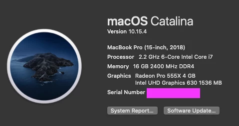

Jun 3, 2020 1:24 PM UTC
Hi there,
Sorry to hear about the trouble. We can surely test this on our end, for that could you please share a few more details like:
  1. The version of Xd and the Operating System.
  2. Will it be possible for you to share the link of the prototype with us?
Regards
Rishabh
AttilaB12Author
Jun 3, 2020 1:38 PM UTC
here:
