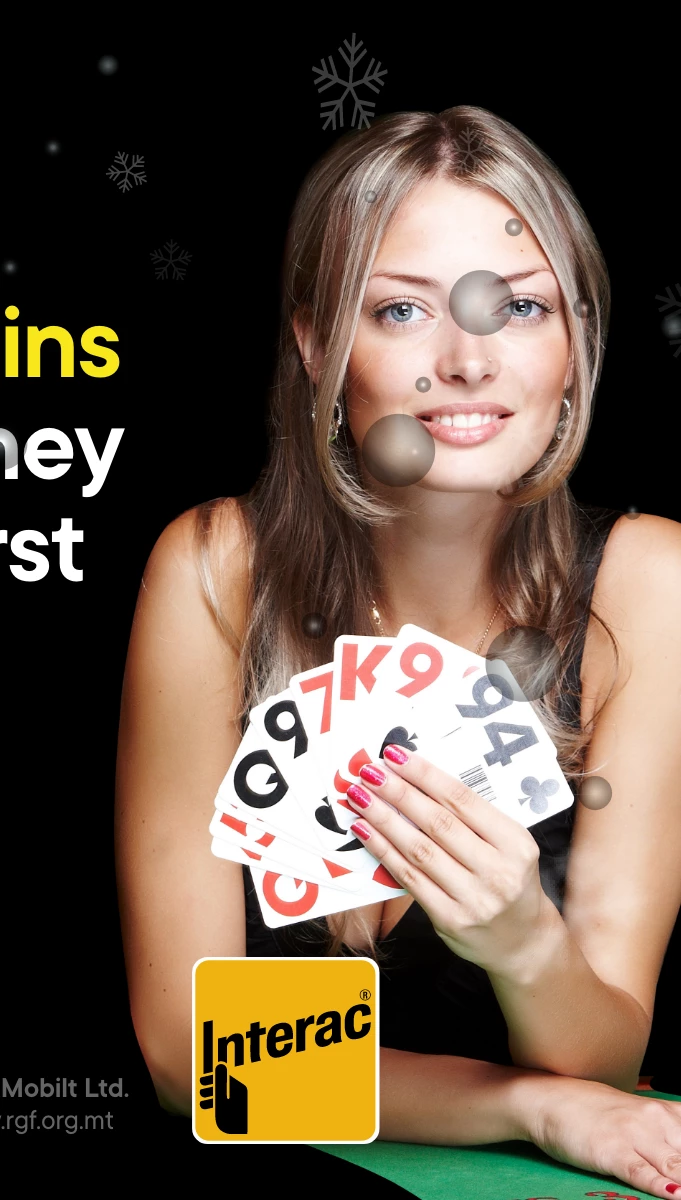

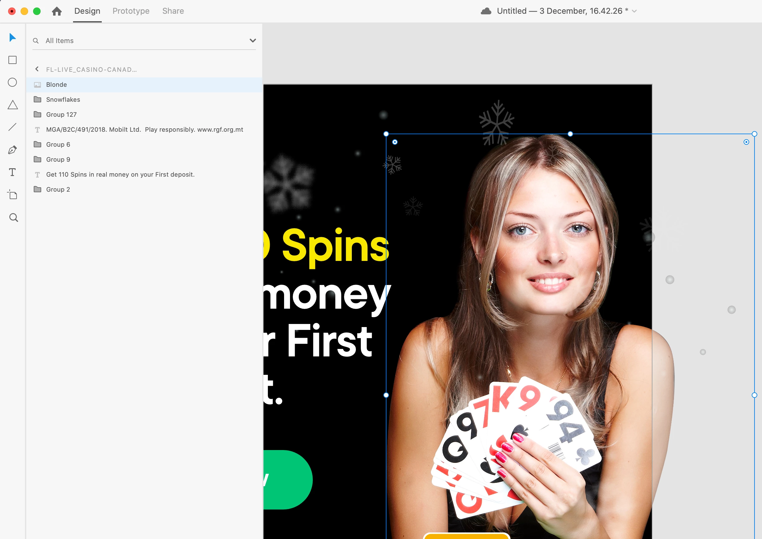

HI, I've been struggling with a really annoying bug,
I have an artboard with an image and some vector elemets stacked behind it, in the layer stack everything seems fine, order of layers is fine, bitmap image on top, vectors behind, but when I export (PNG), the vector layers at the back are appearing on top of the image!

    It seems to me some of the snowflakes are also on top of the girl in your file (maybe they are a part of the image with the girl as well). The only reason I can think of for this is if you are using 3D transform for some of the layers, there might be something going on with the Z axis value, that's causing it to break. Try to make sure the glares are wih a lower Z value than the blonde girl (which is naturally at 0).
    You can also upload the file somewhere and link it here, if it's not an issue, so we can take a closer look and see what might be causing it.
