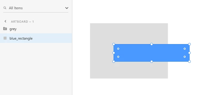

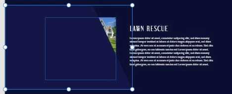

    Jun 1, 2021 9:51 AM UTC
    Hi mate, sure.
    Please find the two images here:
    As you can see on the right, the lighter blue shape should be sat underneath the Images group but instead is sat above?
    I've checked and the 3D option isn't enabled for this project.

    Jun 1, 2021 10:25 AM UTC

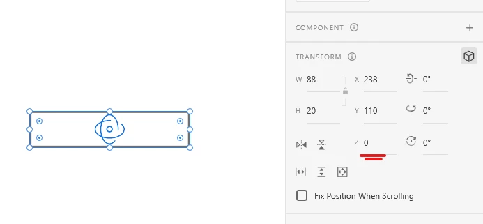

    Very strange indeed. The only way I could break it is to temporarily switch the 3D transform on, set a Z value to the bottom layer, and disable it again.
    The Z value stays, even though 3D transforms are disabled. So please enable 3D transforms, make sure you set the Z value to 0 for all the problematic layers, and turn 3D off again.
    If this doesn't work, try the following - copy the problematic layers over to a new file and see if the issue persists. If it does, it would be nice if you can post the file here (or via PM), so I can take a look at it.
