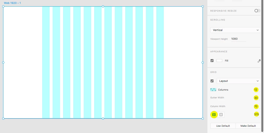

Layout setting in Adobe XD. Why It's Misbehaving . . .?
I have made a bootstrap layout with adobe xd (screenshot-left) where the measurements came out in a pixel perfect manner. Please see the sizing breakdown. But working with this was difficult while designing, as a result I decided to make the layout for this. But couldn't get the specific as seen in the image. How can I achieve that?
Check Screenshot Here: SCREENSHOT-08072019.jpg - Google Drive

It's indeed a nuisance. But currently, the calculation is more concerned with getting the numbers correctly rounded off after each change in any value. While it might be better if it would just wait for you to finish filling out a whole set of desired and correct values, and then verify if it's a valid combination. How should that work ? A warning (which can be overruled), or an OK button (which users are likely to forget) ? Or instantly calculated decimal values, with an indication that these aren't valid yet ? It's a slippery area...

In stead of hunting these self-changing values, set the Grid panel to the linked (symmetric) margin mode and it works.

I'm not being picky here, but I'm sure many people struggle the same way as me:
https://drive.google.com/open?id=1Umzo_DA0cZwtKNKZKh2HVodP8s9Z0tFA
I don't understand the logic of the value readjusting itself.

You are using repeat grid though, that's less useful (hard to snap with and hard to hide/show).
That being said, I don't understand why the "Layout" function isn't inspired from Sketch. XD Layout is really not intuitive. In the case of AllenTomal​we know all the measurements and it's hard to input those in the Layout fields.
So, is it a bug? I don't know. But it's super bad UX, please fix it.

It's indeed easily overlooked, and a bit confusing.
And it also leaves something to wish for, because with this linked margin option I can't apply a top and bottom margin (only after switching back to the 4-sided option). Oh well, it's just like the behaviour that everyone hits the separate rounded corners button, to start setting rounded corners, even when they only need one size for all of them. UX is a difficult matter... ;-)
