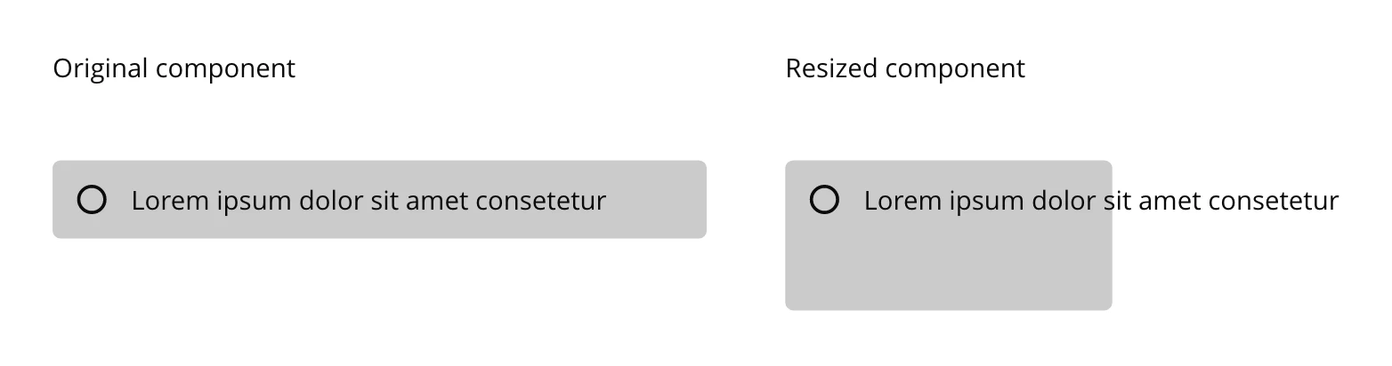

MAJOR ISSUE: resized components with auto height text and padding
A huge issue with components when opening and closing XD as well as published prototypes.
Finding when I create a component containing a text field set to auto height with padding and then resize it, I find that the text does not retain it's resized width when pubished and also when I close then reopen the XD file.
This is a huge issue as not only does it make the use of resizing a single component useless it also means that my clients have viewed buggy prototypes.

I can switch to a fixed size and set the width of the text box to change on the width of the component but this does not re-size the height automatically if the text drops to two lines.
Auto-width does not work when you change the width of the component as it shrinks the size of the text.
