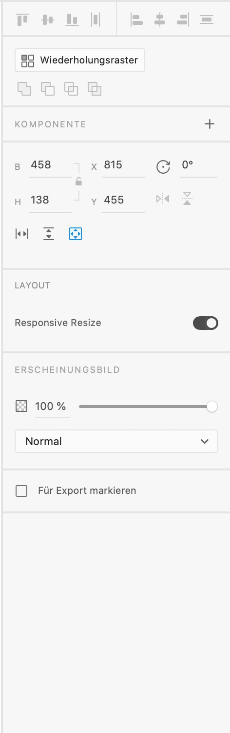

Dear all,
I've got a problem with Adobe XD right now. I found a tutorial for the padding function but there's no button for padding in my XD. (you can see it at the screenshot.) I searched in the manual and looked for tabs, but I cannot find the function. Can you help me with this?
Thanks for your help and have a nice day!
Sascha

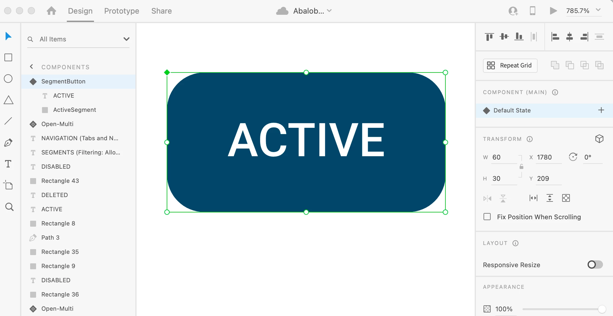

    I have the same problem. I have read all the solutions and have watched a video.
    I have tried grouping. No padding
    This is a main component. No padding
    The background is the lowest level
    XD ver: 54.1.12.1
    Please can I get help. This is a very large enterprise app and I must get my base workflow to be efficient
    Oct 11, 2022 7:47 AM UTC
    I found the solution to my problem. I added a new state in order to get a default state. Padding is only available when default state is selected.

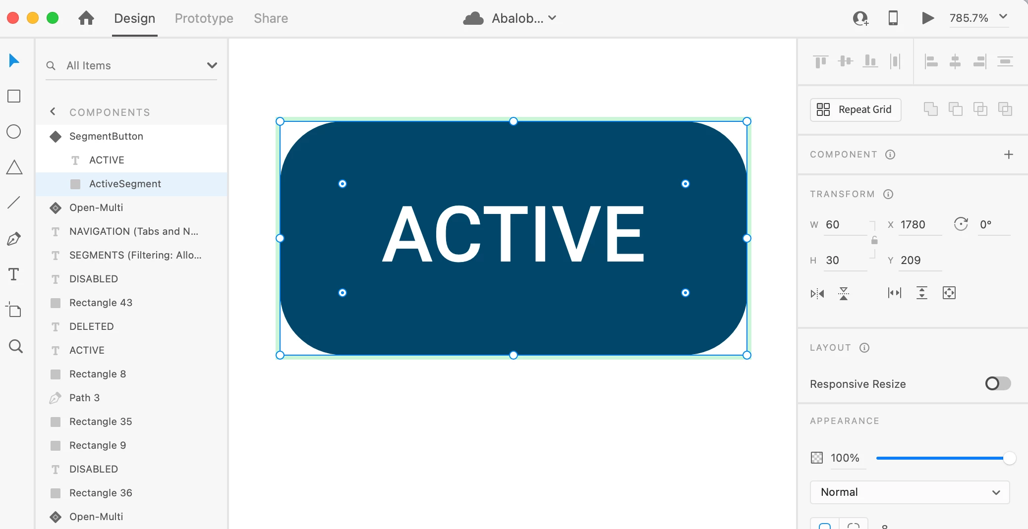

    Oct 1, 2021 8:17 AM UTC
    Can you post a screenshot with the problematic elements selected, and both layers and property inspector panels visible?

    Hi there,
    Sorry to hear about the trouble, we'll try our best to help you with it. Usually when we group the objects or if it is a component we do get the option for padding as suggested above. Could you please share a few screenshots of the design of how it looks so that we can have a better idea.
