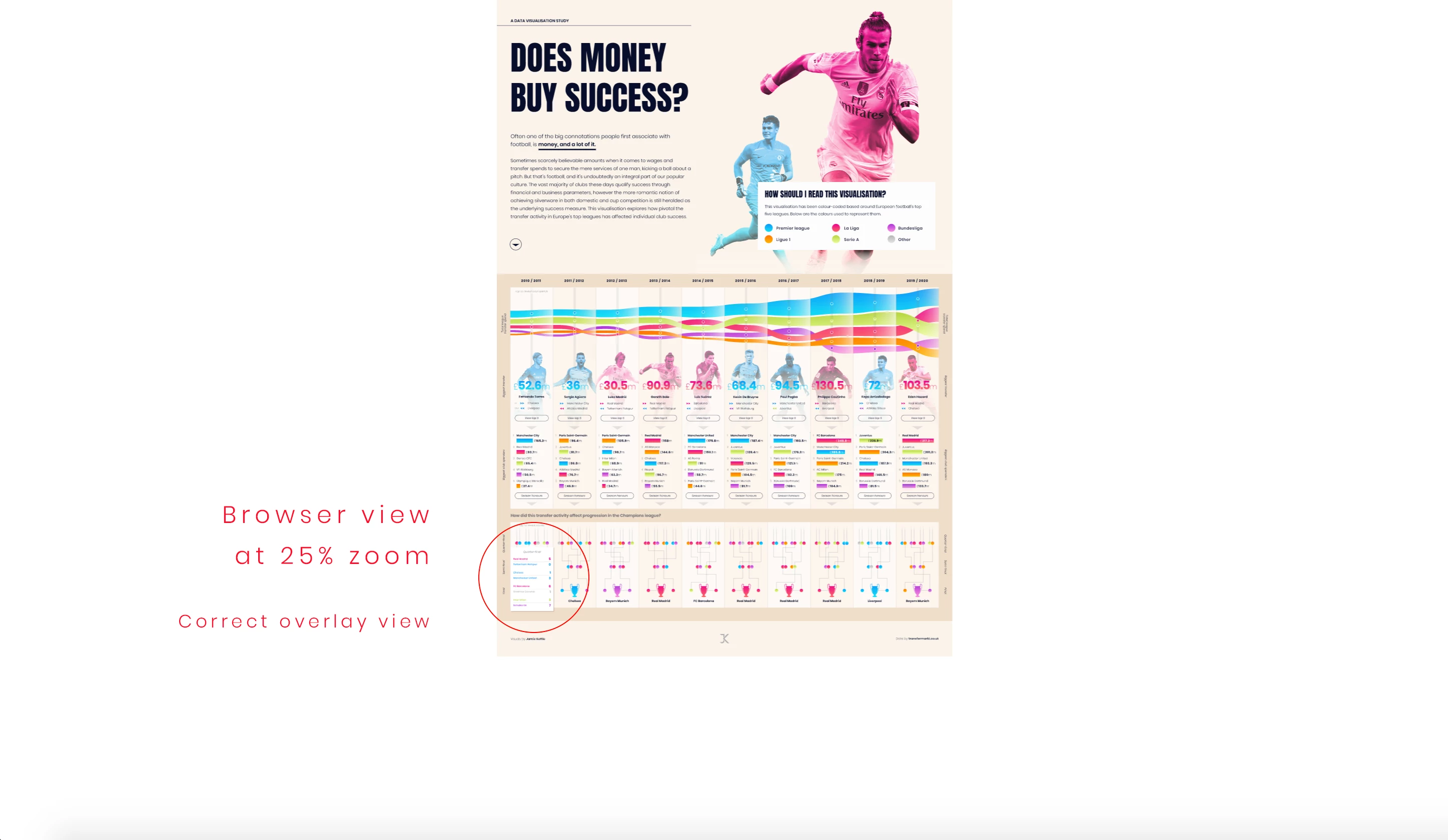

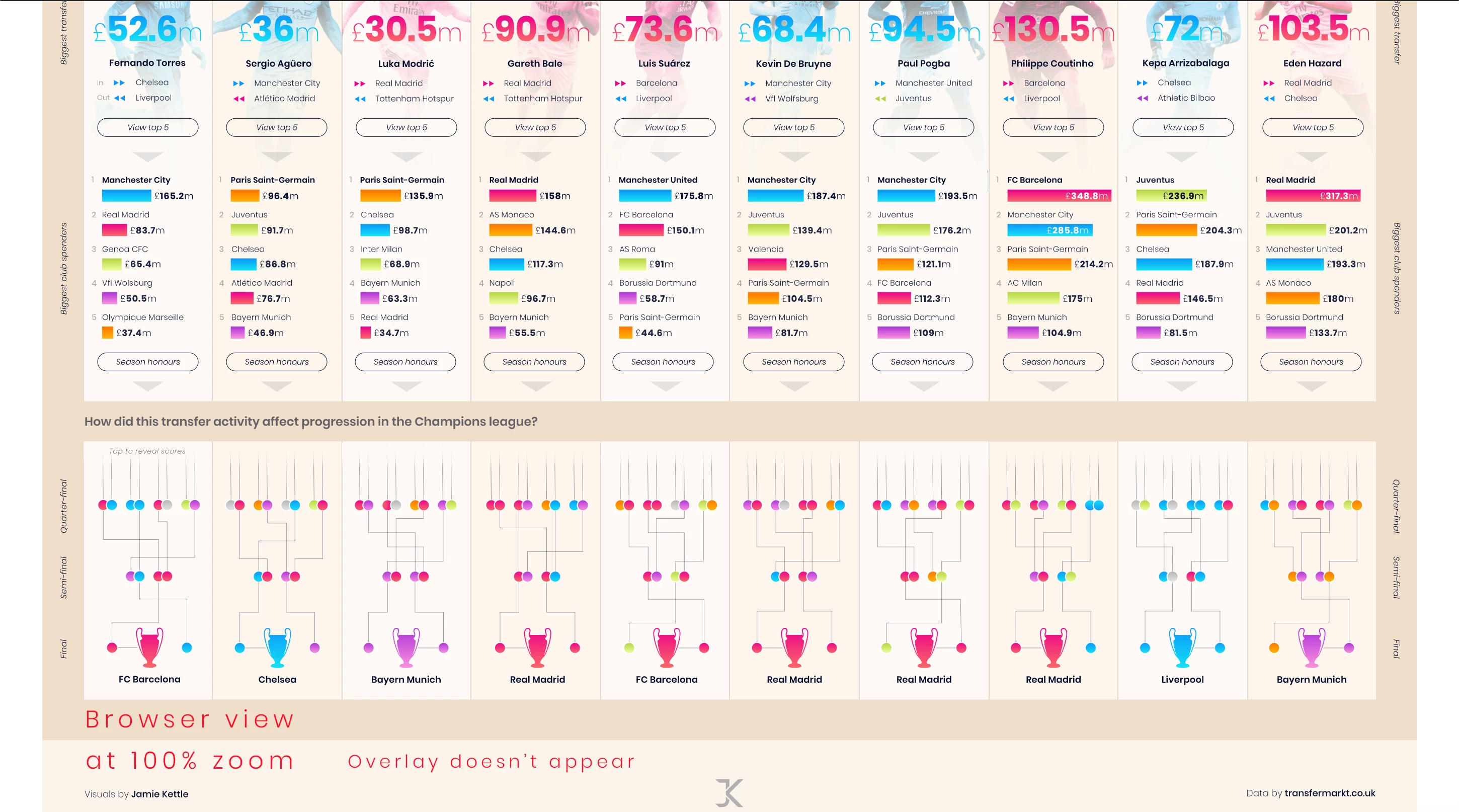

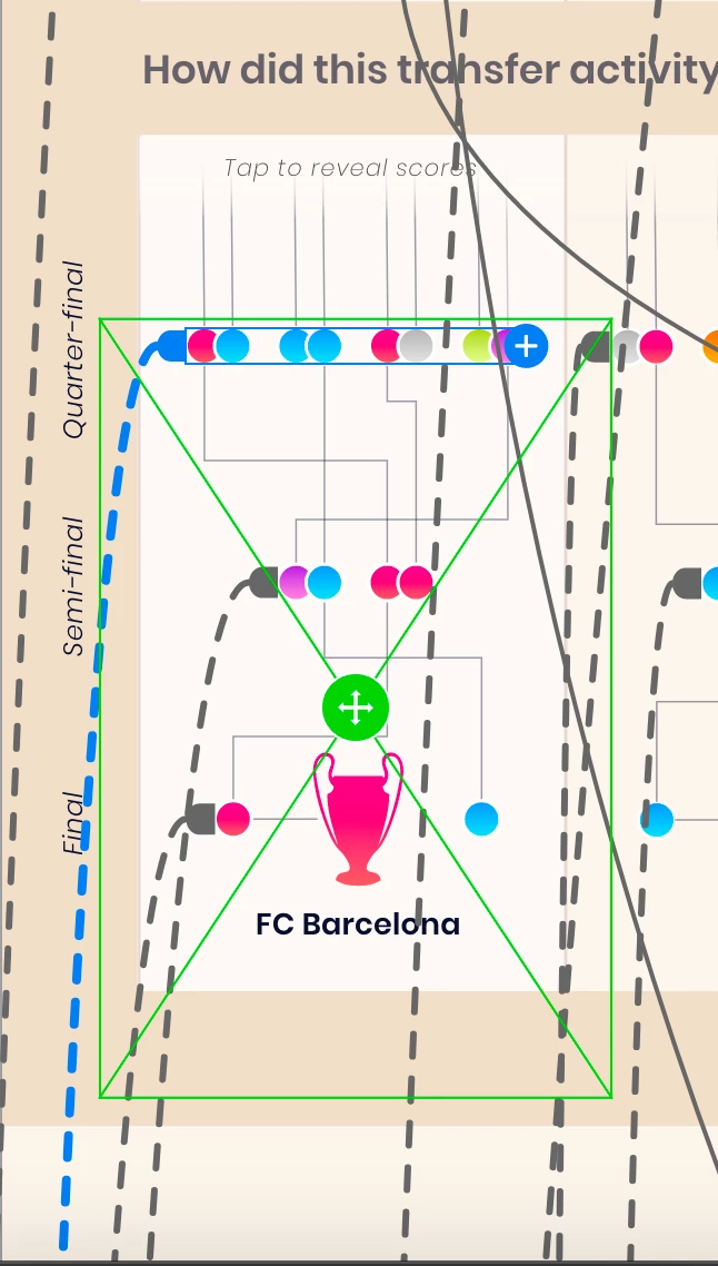

I'm trying to use the overlay feature in my design, which is functioning correctly in prototype mode, but not showing correctly in browser view.
It either, doesn't show at all, or displays but in a different position to the one I placed it in prototype mode.
I've also found that the only way the overlay functions properly is if I zoom out to 25% (see attached image). However, any closer to 100%, it just doesn't work... There's been two occassions where it's worked when I've zoomed back in, but 95% of the time it doesn't show.
There's other overlay functions I have within the document that are behaving in the same way, but I'm assuming that the cause of the problem is the same.
Hopefully someone can help? Would really appreciae it! I've attached photos to illustrate the issue I'm having.

It seems to show the overlay much further down than it should, but rectifies itself when zoomed out. I don't understand why the zoom resolution of the browser is affecting this. As the overlays function perfectly in the prototype mode in XD.
