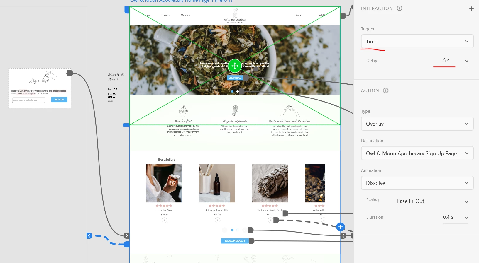

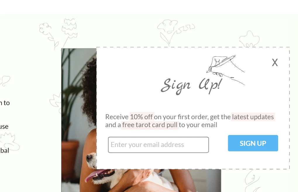

I have a problem in which my sign up, overlay page keeps appearing in the home page.  I had timed it to appear, but when I click "X" to close the sign up page, the sign up keeps coming back on seconds later.  It is annoying and I don't know how to get it to appear just once.  Please help!  I've attached images below to help explain what I mean.  🙂

    @Ben_Huang  Once artboard is set with time trigger, it will constantly pop up the target artboard until focus move to other artboard. So, either you need to change trigger or navigation need to move some other artboard once you click X.

    Hi Ben,
    Its happening because you set the Time trigger for artboard , please change the trigger from time to tap, so it won't pop up after every few secs.
    I hope it is helpful. Please revert back for any queries.

    Hi Anita,
    Thanks for your reply.
    I deliberately Time trigger the Sign Up page so that it would appear within the first few seconds of landing on the home page, but once I click X, it will not appear again.  By triggering to tap, the Sign Up page will not show up at all on the home page.  Is there an option to Time trigger just once?
