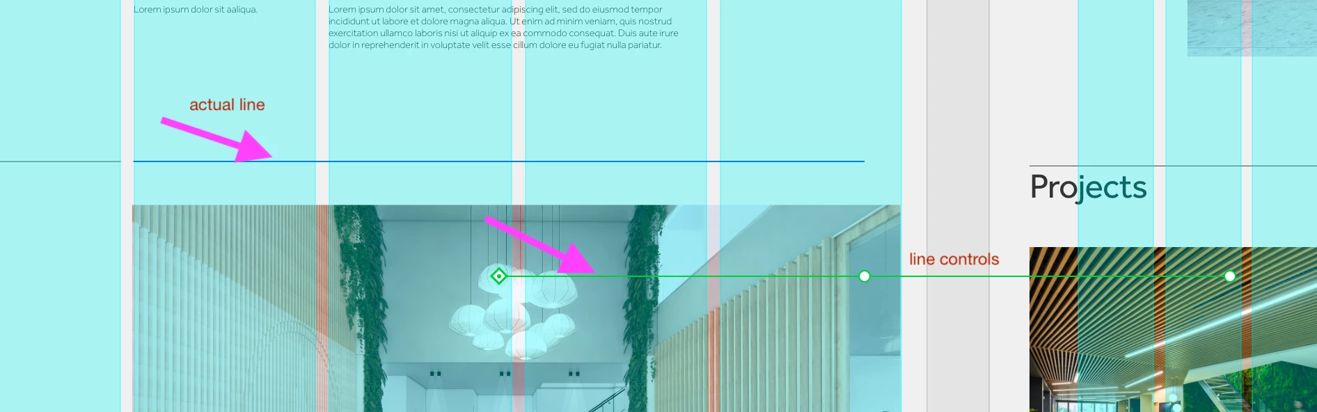

    Thanks Randy but this isn't my issue. My lines are INSIDE the artboard. They are part of my design. But when I go to the layers panel, they are sitting on the pastboard, and copy/cut/paste doesnt work to move them back into the artboard. Aditionally, the controls for the lines are offset from the actual line. This is clearly a bug.

    Yes, I saw your response in the "Lines in Adobe XD don't end up on artboard but on pasteboard" post. The original post looks like a bug, but I am unable to reproduce it, so I'm not sure what's going on. I can't tell much from your screenshot.
    I recommend that you start a new post with the simplest set of steps to reproduce the problem in a new document. As I said, I have already tried to reproduce it, so there is a subtle difference somewhere. Specify your version of XD, OS version, type of hardware, etc.
    Take a video with slow steps and show as much of XD as possible -- it helps to be able to see canvas decorations, PI values, which canvas mode, and any other cues that may help figure out what's happening.
