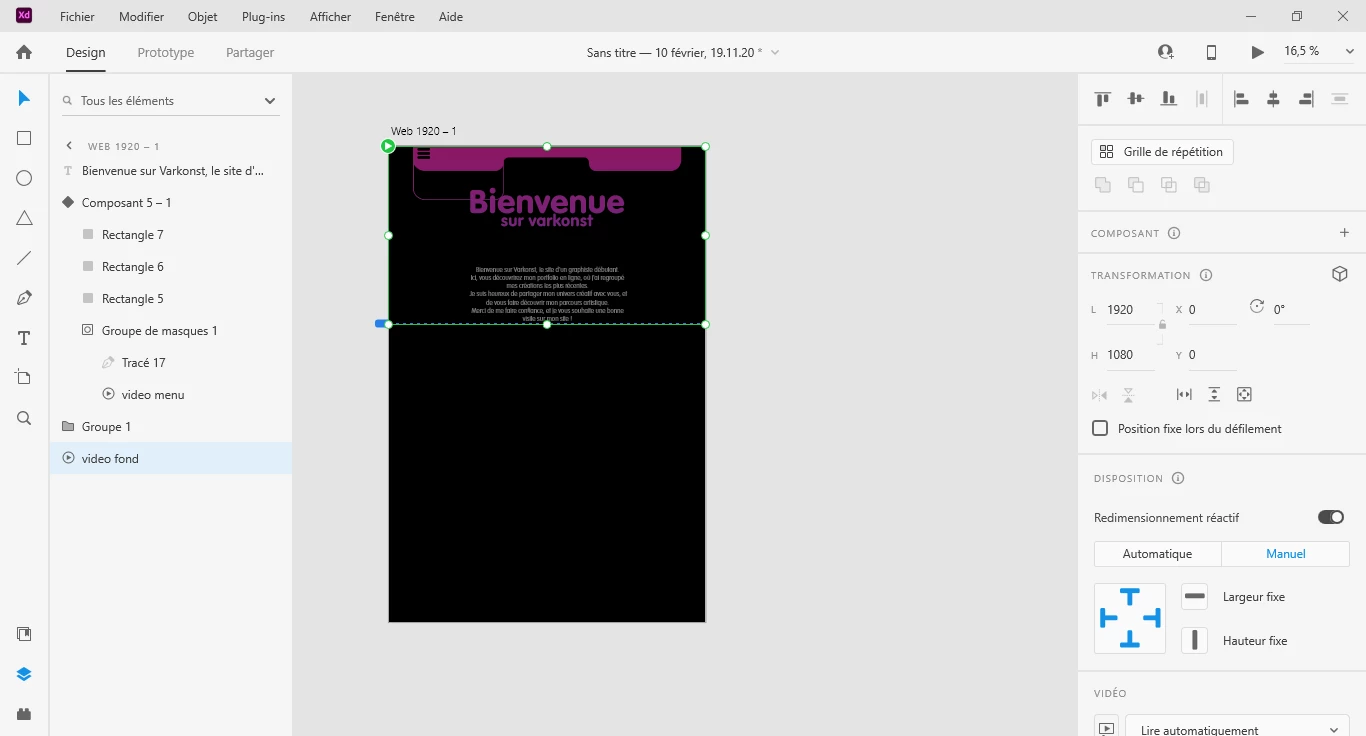

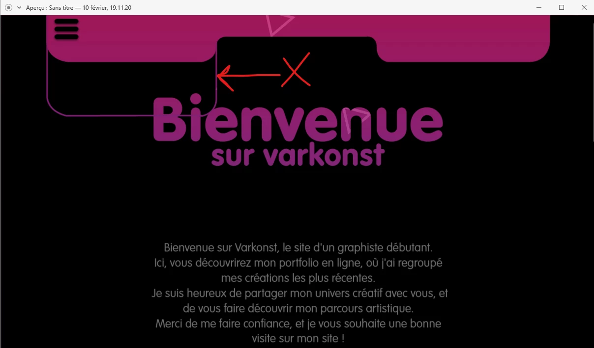

    Feb 13, 2023 5:30 PM UTC
    hello, as you can see i dont know why le menu video dont work, ( a the x point in the 2nd picture) , I put the video on loop and autoplay.
