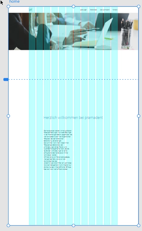

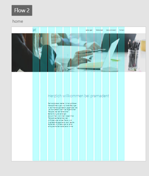

Problems by resizing the artboard
when i extend the drawing area downwards, the elements on the artboard move with it, and are distributed proportionally depending on the dragging; although i only selected the artboard with the selection tool.
But I only want to change the height of the artboard without moving the designed elements.
what am i doing wronghttps://drive.google.com/file/d/1hQlqGyZRznprAbfVHY5YBxw-iDdiWLEO/view?usp=sharing

    Hi there,
    Thank you for reaching out. It looks like you're trying to resize the artboard only but the content inside also changes as you resize. You can fix the content inside the artboard by fixing the position of the object and then resize the artboard.
    Let us know if that helps.

    Thanks for the proposed solution
    I have solved the problem by disabling "Responsive Resize" when dragging the drawing area.
    Best regards
