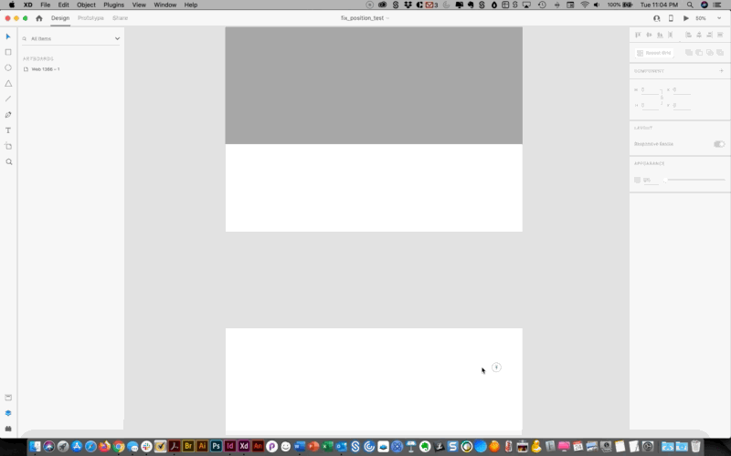

[Prototype]-Element that has "Fix position when scrolling" applied to it disappears in preview mode.
I created a back to top arrow that I placed towards the bottom of the page. When I select that arrow and click on "Fix position when scrolling", and then I preview it, the arrow disappears from the page all together. This must be a bug. I read in another post from an Adobe certified user that the element needs to be within the viewport of the page in order for it to be seen. I tried that and it worked. However, the problem is, the back to top arrow is all the way down towards the bottom of the page, so I would have to increase my viewport to close to the bottom of the page, which is not what I want. I want my viewport to only show the hero area. Is there a fix for this???

Hi. Here is a gif of my issue, the element disappears in Preview mode. Hopefully you have a solution for this. Thank you.
Angelo
The element is already positioned far BELOW the viewport (I can see the dotted blue line in your GIF above it). So this way it will always start and stay out of view, as you have noticed.
Maybe you'd like it to move up wih the screen, until it gets into view, and then stay there. This behavior can't be created within one artboard, but you could use a sequence of 2 or 3 artboards and Auto-animations, to mimick this behavior.
As the saying goes:
You can't have your cake (fixed outside of the viewport) and eat it (inside the viewport).
