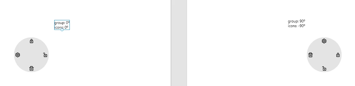

Create a circle with the icons on it in the first artboard and group it. In the second artboard, copy/paste the group you created and rotate it 90º clockwise. Rotate the icons inside the circle -90 clockwise. Auto-animate these artboards. The circle will turn and the icons will follow it.

Do the following:
