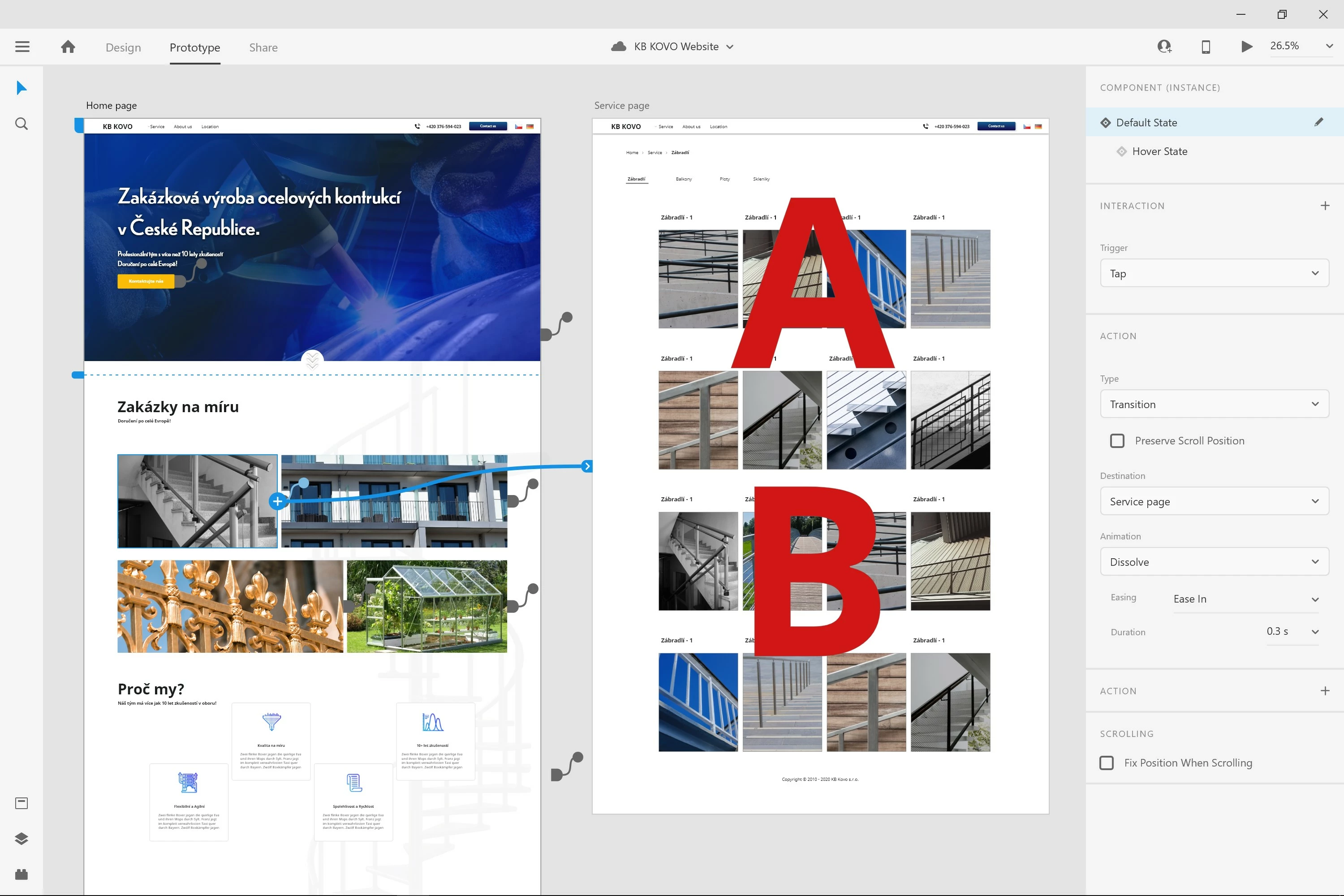

Mar 12, 2020 7:23 PM UTC
Hi I might have the same problem, without the Preserve Scroll Position choosen, it gose to the middle,
do you suggest that I set something wrong? Thank you.

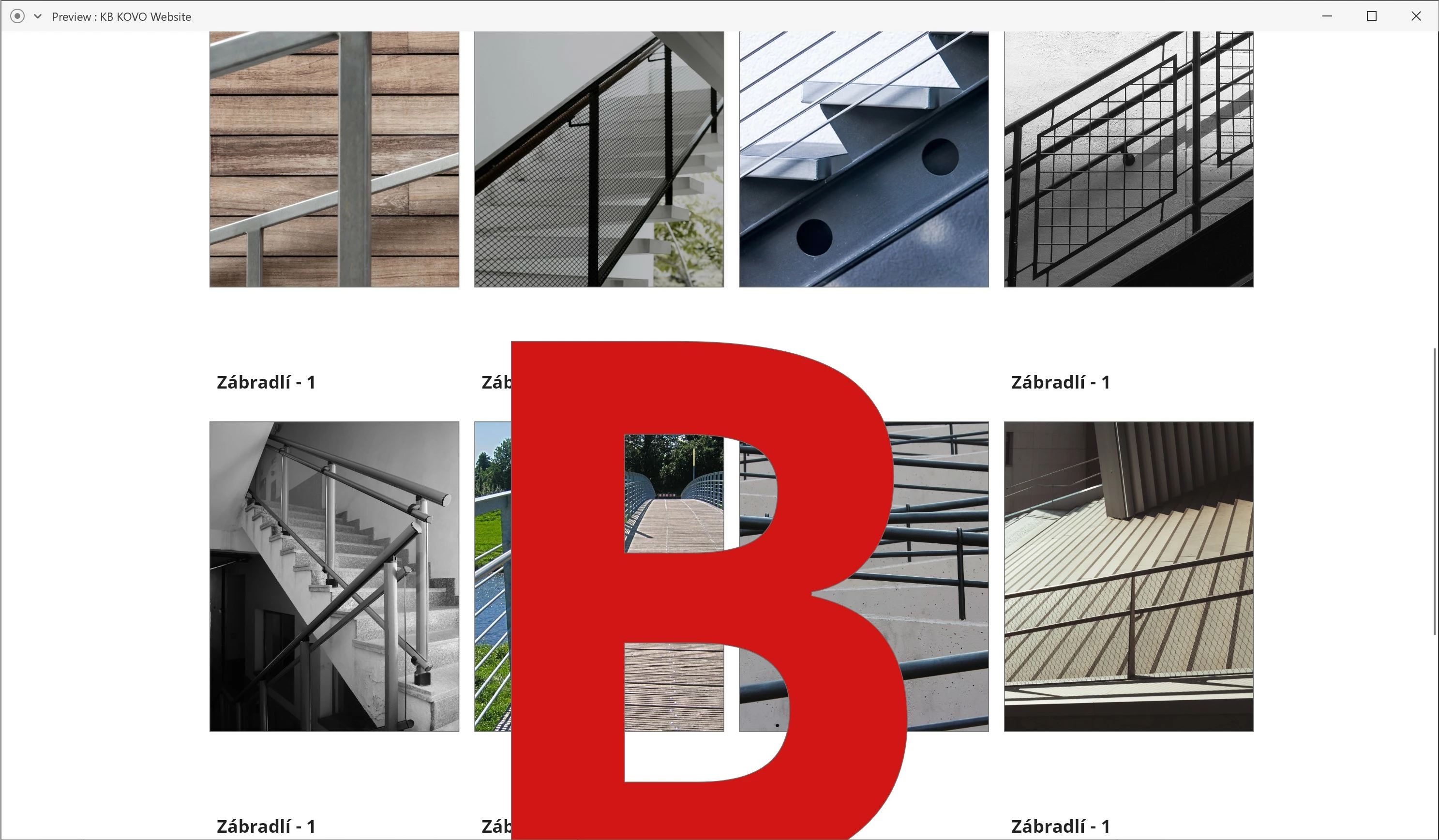

In preview mode, if I click, the screen should bring me to the top of the artboard that shows "A":
But insted it bring me to somewhere arround the middle of the page:
Jan 26, 2023 10:46 AM UTC
Just keep Action - Type -> Transiton (and not "Animation" or other). Then the linked page will start at the Top!
